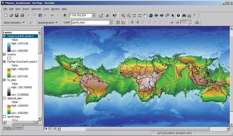

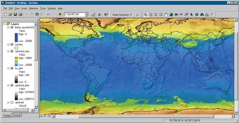

To illustrate, imagine what would happen
  • if the Earth was spherical but maintained its rotation
  • if the Earth stopped rotating but maintained its current shape.
http://www.esri.com/news/arcuser/0703/geoid1of3.html" answers these questions.
  • If the Earth Was Spherical
    This change in geometry to a spheroid geometry with its altered gravity would cause the global ocean to change. The polar zones would be relatively farther from the center of the earth, and these new higher altitudes would force seawater toward the equator. By the same token, the equatorial region would be relatively closer to the Earth's center and would be more strongly affected by gravity. Increased gravitational force in the equatorial zone would pull oceanic water toward the equator and form a global equatorial ocean.
    [*]If the Earth Stood Still
    What would happen if the Earth stopped spinning and the centrifugal effect ceased to force oceans to accumulate around the equator? It appears that the world's ocean would split into two polar oceans and leave the equatorial area totally dry. To model this hypothesis, a value of 6,371,146 meters—the distance from the Earth's center indicates the approximate elevation of the sea level on the reference ellipsoid—was specified to separate water from land. For this "what if" simulation, the elevation of the sea level was based on the assumption that the volume of ocean water would be about the same as it is today.
The attached images illustrate the above thought experiments.
