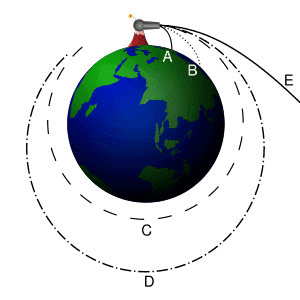

Ok, I have read your website. From there I under stand how objects orbit. By looking at this picture, I can understand how an object fired out of this cannon may or may not orbit depending on how fast it is fired. If it is fired with a low velocity, it will end up at point A. With a little more velocity it will end up at point B, and with too much, it will escape the Earth's gravity, and continue out in space as in point E. You must have the perfect velocity to keep something in a circular orbit.
This may explain why the moon stays in orbit around the earth, and how the planets stay in orbit around the sun.
1) But it doesn't explain why the Earth spins on its axis. Also,
2) It doesn't explain what caused objects to move at this perfect velocity the first place. I'm pictureing a huge cloud of dust. I can see that all over the cloud, pieces clumping together. Eventually, large clumps would form spread through the cloud. Nothing would be in a perfect disk. And eventually, the large clumps would suck in everything that was close enough, and you would just have large clumps of matter, spread at large distances from each other, all through out this cloud. They would be sitting still, not close enough to any of the other large clumps to effect each other.
So in order for our solar system to form. Gravity would have to get these large clumps moving again.
Can someone explain 1 and 2?
