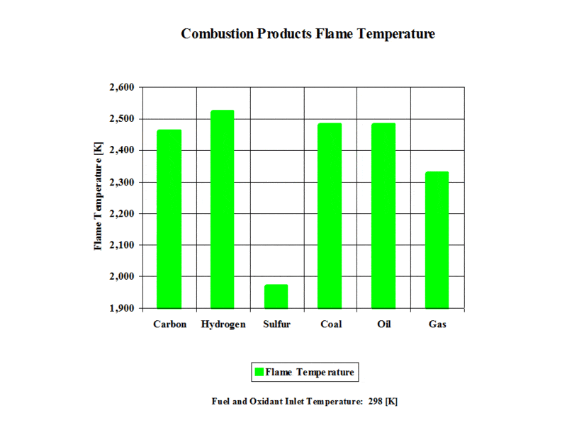

Here is a plot regading combustion products flame temperature for ideal and complete stoichiometric combustion conditions.
I do hope that the provided URLs will cover some of your concerns when doing engineering calculations related to the technical performance of simple power cycles and combustion.
