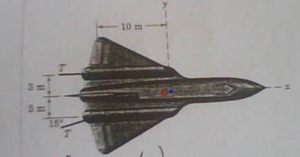

Hey guys and girls, I am new to this forum but been looking at it for a while, its a great read and always a challenge here or there, but for now i was hoping to get a little help
The direction of the two thrust vectors of an experimental aircraft can be independently changed from the conventional forward direction within limits. For the thrust configuration shown, determine the equivalent forces-couple system at point O. then replace this force-couple system by a single force and specify the point on the x-axis through which the line of action of this resultant passes. These results are vital to assessing the design performance.

of the middle of the plane is Point O giving me a moment i can rotate on

As noted, your image wasn't too clear, and now I don't see it at all. It appears though that you should find the resultant of the 2 thrust force vectors (magnitude and direction), and the torque of those 2 vectors about point O (break the lower thrust vector into components for simplicity in calculating its torque), then place that resultant force and couple at O. To find the equivalent force through the x axis, I'd divide the couple by the y component of the resultant force.

im not to sure what i can do with that angle of thrust
at 15degrees

Nice pic. As I mentioned earlier, the resultant force is the sum of the 2 thrust vectors, and the resultant moment about O (couple, or torque, if you wish), is the sum of the moments of those vectors about O. Try breaking each vector into its x and y components. The upper force has an x component only. The lower one has an x component of Tcos15 and a y component of T sin 15. Sum torques of those componnents about O, watch plus and minus signs. Show your work so that we may be of further assistance. Your result will be a function of T, which is not given.
is the answer 2.69T
Mo = 0: T3+tsin15x10 - Tcos15x3

Your picture seems to come and go quicker than the Chesire Cat. I think as I view it that you have 2 thrust vectors T, spaced 6 meters apart vertically, 3 m each from the x axis. One is horizontal, the other 15 degrees up from the horizontal. I don't see how yu can arrive at 2.69T as a resultant ...even if they were both horizontal, they'd add up to 2T, so surely the resultant must be less. You are just going to have to show your work if you need more help. Your moment looks good, but don't set it equal to zero, it is what it is. Then you still have to determine at what point on the x-axis the resultant falls.
