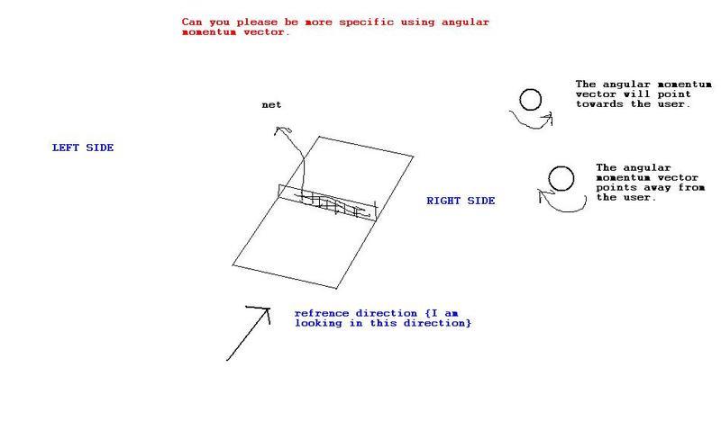

Basically, what I mean to say is that let's say I am playing ping pong...I put a lot of sidespin on the ball.(from back to forward vise, not up to down...how hurricane spins, not how clock runs)
If the ball is rotating to the right, shouldn't it travel to the left b/c wind is the median. Similar to how the tire travels on the road.
Am I being clear?

Hi
I am raghunath, your thought is interesting..
Can you please be more explicit...
letz take the ping pong board as the refrence and when the ball spins specify the direction of angular momentum vector.
Please see the attachment.
I explained it spinning on the side, counterclockwise if you look from the top. So if you hit the ball I am talking about, and you are right handed, you would hit it on the right side most likely or else move the paddle from the left side of your body across to the right side and beyond.

Hey Jeff...I still didn't get the concept back then...but I thought may be I should ask my physics professor but he seems to be harder to get hold of than I thought. And now, my assignment is due...so I am sorry for doing this...but could you explain more explicitly what you did earlier? I will phrase my doubts on those.
“When a table tennis ball is spinning and moving laterally, a very thin layer of air remains somewhat "attached" at the surface of the ball, quickly diminishing with distance from the surface, but it's enough to create a resistance to lateral airflow. This resistance results in a difference in acceleration of air on the forwards and backwards spinning surfaces, which results in a pressure differential, which in turn cause the ball to curve away from the forwards spinning surface.”
What do you mean by saying the air is attached? And how is it attached?? Why does diminish away? What the heck is lateral airflow? Now, once I can get these questions answered…then I can try reading what you wrote down further. Thanks a lot by the way for helping me out with such sincerity(that goes for the rest of you too.)
I tried reading further anyways….
“the forwards spinning part of the ball accelerates air forwards (in the direction of ball travel)”
Why and how?
I think…I understand the rest…thanks again the favor.
By lateral I meant in a straight line, as opposed to rotational.
If the ball is moving and not spinning, it's accelerating the air in the direction that the ball is moving, which reacts with an opposing force, drag.
If the ball has backspin, then the bottom surface of the ball is moving forwards faster, and the top surface of the ball is moving forwards slower (or backwards if rotational surface speed is faster than latera [forwards] speed), than the non spinning case. The bottom surface of the ball accelerates the air forwards a bit more than the non-spinning case, and top surface of the ball is accelerating air forwards less than the non-spinning case. This creates a differential in acceleration of air, more at the bottom, less at the top (in the case of backspin). The greater the acceleration, the higher the pressure because of the air's momentum and resistance to acceleration. So the differential in acceleration of air corresponds to a differential in reactive pressure, higher pressure below, and lower pressure above. Air can't flow through the ball, so there's a net downwards acceleration of the air because of the pressure differential, and the air reacts with an opposing upwards force on the ball, "lift".
Air "attaches" to the ball because of friction between the air and the ball. This boundary is not infinitly thin, because of "friction" within the air itself, called viscousity. The result is a small amount of air that spins in the same direction as the ball, diminishing with distance from the surface of the ball.
Wiki has an article on this:
http://en.wikipedia.org/wiki/Magnus_effect
Personally, I prefer Newton explanations for "lift" as opposed to Bernoulli explanations. With the Newton method, the focus is on acceleration of air and the corresponding reaction force. With the Bernoulli method, the focus is on relative velocities of air streams, which are meaningless unless the causes for these air stream velocities is known. Also with the Newton approach, it's clear that work is being done on the air, while in some cases work done on the air is ignored with Bernoulli approach.
Another issue with the Bernoulli approach is that its frame of reference is based on an object, not the air itself, similar to a stationary object inside a wind tunnel. An association is made between "faster" moving air and lower pressure. However change the frame of reference to the air itself, similar to a ground observer in a no-wind condition, or an observer hovering along with the wind in a balloon. From the air's frame of reference, the faster moving air is the result of acceleration and is associated with higher pressure, not less.
update - see next post.
