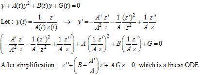

HI !
The Riccati ODE can be transformed to a linear ODE, even without knowing a particular solution (see in attachment)
