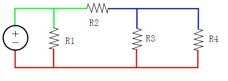

In the picture above
R3 & R4 are in parallel
R1 & R2 are in series

Yep R3 and R4 are in parallel.
If resistors are not in parallel, it does not necessarily mean they must be in series. R1 and R2 are not in series. If there was a current coming out of the left of R2, it would split up at that junction, so not all of the current through R2 would go through R1, some would go through the voltage source.

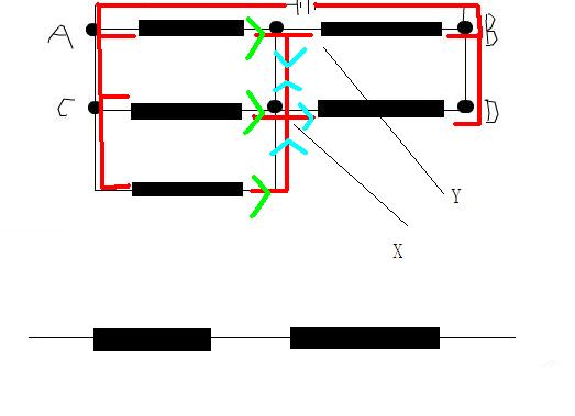

R3 and R4 are in parallel , do their Voltage equals to the cell?
Or the voltage of RED and BLUE nodes are the same?

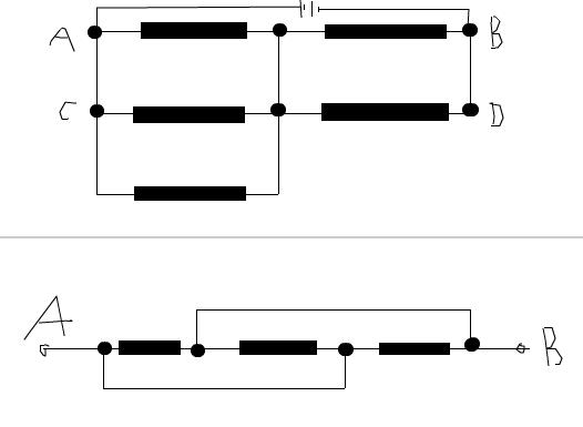

Secondly,In picture above, it seem current would split up in Junction X and Y
however the answer is two resistor in series.Why?
The red and blue nodes are at different voltages.
Have you drawn the diagram correctly? I wouldn't have thought there were any in series.
He meant to say there the problem may be reduced to 2 equivalent resistors in series, which is correct. For the second one, I suggest you denote one node by VA and the other by VB. Then trace out all the possible paths between VB and VA. You'll find that it reduces to a single configuration.
EDIT: danago, I think you're looking at the wrong circuit. He was referring to his, not the Wikipedia one.
