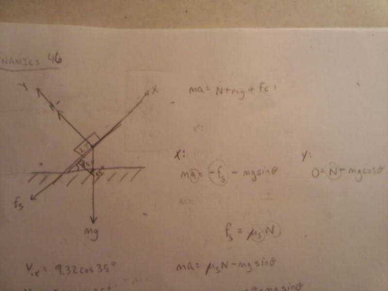

A 2.37 kg wood block is launched up a wooden ramp that is inclined at a 35° angle. The block’s initial speed is 9.32 m/s. What vertical height does the block reach above its starting point?
DYNAMICS
3. The Attempt at a Solution
no matter what I do i end up with a=g(ukcos(theata)+sin(theata)) is this right how am i setting it up wrong?

Assuming there is friction (your first post doesn't mention any), that's the correct expression for the acceleration of the block along the incline. Was the problem statement in your first post complete?
I believe so. I took fs=us*n...and replaced fs with us*n. Is that wrong?
or should i assume there is no friction?
Your initial problem statement doesn't mention friction or give a value for μ. What makes you think there's friction involved here?
I think friction should be involved because its wood on wood, and when wood rubs against wood there is friction. Am i just thinking to much about this problem? If there is no friction then my acceleration would be just be gsin(theata). Correct?
Most likely, but this is a physics problem so often things are ignored. You can only tell by context. For example, are you given a chart of coefficients of friction to use?
I suspect so.
Correct.
We weren't given a table there is one in the book but there is no wood on wood coefficient given. Thank you Doc Al, I am going to take the appoarch without friction and see how it goes and post back on here with what I come up with thank you.

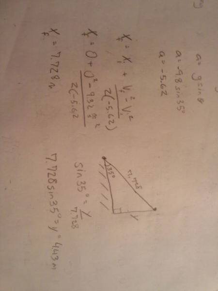

Ok so i got the acceleration, which is negative because it slow down so can i just use Vf=Vi+(a*delta t) to find the time and then just use the kneimatics equation yf=yi+ (Viy*deltat)-(.5*g*delta t^2)? I tried that and it was wrong. Do i subsitute the gravity with the acceleration i solved for?

Of course! Use the acceleration you figured out.
Be sure to convert your answer into the form they ask for: The vertical height, not the distance along the ramp.
You can also use a different kinematic equation that combines the two you are using into one step. Save a little work.

No. The block moves along the ramp, you found its acceleration parallel to the ramp, and that equation will find the distance traveled along the ramp. But you can easily use that answer--with a bit of trig--to find the change in height.
ahhhhh. Making since now!
but wait...wouldnt the equation i use to find the length it travels up the slope be...
Df=Di+(Vi*delta t)-(.5*a*delta t^2). The Vi is the Intial velocity not with respect to the y axis? and then the a is the calculated a?

You could certainly use that if you knew (or figure out) the time. (You could also you a different kinematic formula; one that relates, a, v, and d together.)
Right. The initial velocity you were given is parallel to the ramp, and the a needed is the one you calculated.
Ok this is all my work but it still said its wrong...
Looks OK to me. If this is one of those online systems, they can be picky about significant figures.
The only other thing I can suggest is to do it over including friction. But unless they give you the coefficient, I don't see how you can do that.
yeah that was the initial problem. and wood to wood coefficient can be between .25-.60 so i don't see how i could even pick one. Your the man Doc Al! I would be completely lost without u. Even when I don't get rid of any significant figures til the end i still get 4.430 so... I am just going to email my professor and tell him I did all the work right but it didn't work.

That second part is trivial if there's no friction, so I suspect that your professor does intend you to include friction. (Which makes sense, else why specify wood on wood?) Perhaps you can email him for the μ he wants you to use.
This part isn't working either when i know all of the work is right...If I use the distance it traveled up the ramp which was 7.728 m. mhhm its ok I emailed him
yeah I emailed him. I sent him a picture of my work and asked if we were suppose to use friction and that if we are suppose to use it what coefficient does he want us to use. There is no other way that this can be solved can there?
