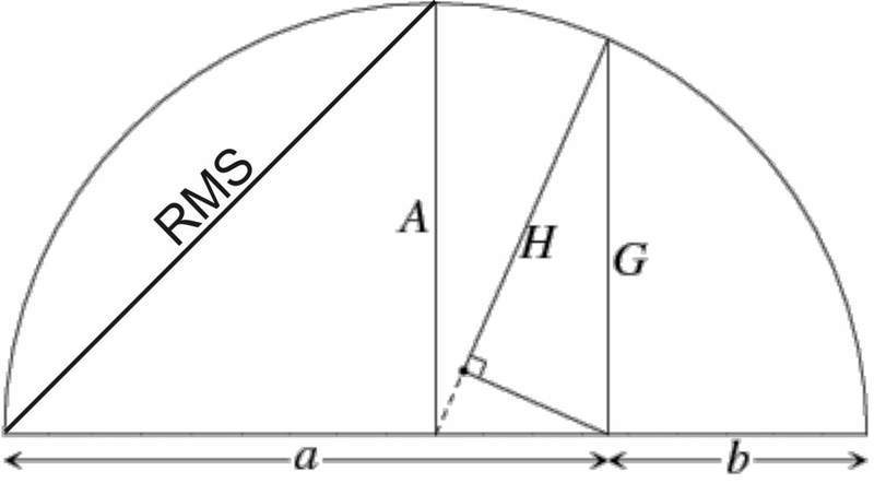

Today I was thinking about the root mean square, and I figured out a definite relationship with the Pythagorean theorem. Specifically, the root mean square of the legs of a right triangle is equal to the "average leg," i.e. the leg of a square with the hypotenuse as it's diagonal. It appears to me that this is a fairly interesting and important connection, certainly applying to distance on Cartesian coordinates and maybe explaining the usefulness of the RMS. However, when I googled it, nothing came up! I'm trying to see if this relationship has any meaning whatsoever, which I believe it should, and if so, what it means. I'm pretty sure my math isn't wrong.
Thanks for the attachment, but there seems to be something wrong. I tried substituting a=4 and b=3. The RMS is then 5/[tex]\sqrt{2}[/tex]. But the line labeled RMS in the figure should be of length 7/[tex]\sqrt{2}[/tex], right? It looks like the diagonal of a square with side A--or the arithmetic mean, which would be 7/2--and the diagonal is always equal to side*[tex]\sqrt{2}[/tex]. Correct me if I'm wrong. Thanks again!

I should clarify exactly what I mean.
Let's say you have a right triangle with legs a and b and hypotenuse c.
The Pythagorean Theorem says that a2 + b2 = c2.
Now, the root mean square of the two legs is [tex]\sqrt{(a^2 + b^2)/2}[/tex]. But wait! Combine the two equations to get,
RMS of a and b = [tex]\sqrt{c^2/2}[/tex] = c /[tex]\sqrt{2}[/tex]
Now imagine a 45-45-90 triangle with legs equal to c /[tex]\sqrt{2}[/tex]. The length of the hypotenuse would then be
c /[tex]\sqrt{2}[/tex] * [tex]\sqrt{2}[/tex], which is equal to c. The conclusion is that the RMS of legs a and b gives you the leg of a 45-45-90 triangle with the same hypotenuse c. A little extra work shows that it applies to 3 or more dimensions too.

Does standard deviation have something to do with this?
http://en.wikipedia.org/wiki/Standard_deviation#Geometric_interpretation"
This is essentially what I'm talking about, although worded differently. Seems strange that nowhere else mentions it; you'd think this is an important fact!
So can standard deviation really, formally be visualized like this? If you take a data set, can each data point's deviation be considered as inhabiting its own "dimension"? Does it have mathematical significance at all?
