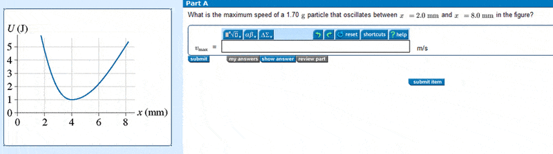

The Question
Relevant equations
KE=0.5*m*v^2
T=2*pi*sqrt(m/k)
EE=0.5*k*x^2
KEi+UEi=KEf+UEf
I think that's all of them
attempt at a solution
I was thinking about just using the conservation of energy at the the equilibrium point, as the kinetic energy would be at a max there and the potential energy would be at its minimum, Also the velocity would be at its max while the acceleration would be zero. However, one of the many problems I've run into on this question is that I'm unsure if the average of the two x values will give me the equilibrium point (if it did then it would be 5mm) and I don't feel comfrontable moving on having possibly made a false assumption.
I got the answer :) but for others what I did was
from the graph u can see that potential at highest point is 5J and at lowest point is 1J
mgh+ 1/2mU^2 = mgH + 1/2 mV^2 in this U = initial velocity = 0 and V = max velocity at lowest point and mgh is initial potential energy and mgH is potential energy at lowest point.
this gives
5 + 0 = 1 + (1/2 x (1.7/1000) x V^2) [ 1.7 is divided by 1000 to convert grams into kg]
V^2 = 4705.88
V = sqrt(4705.88)
V = 68.59 m/s
