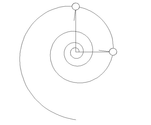

If you spin on a chair with your arms and legs out and then pull them in, your rotation accelerates. What torque is responsible for that acceleration? It seems to me all the movement is towards the axis of rotation and should not be responsible for any torque. In fact, take an idealized body that can reduce its radius with movements entirely towards the axis of rotation. Where does the torque come from?
I know that the moment of inertia has changed, and from that point of view it makes sense that the angular velocity would increase. I was just trying to look at it from a free body diagram perspective.
The path that your arms take when being retracted is a inwards spiral. Part of that force is in the direction of travel of that spiral path, so the speed of your arms increases. In order to keep your arms orientation constant relative to yourself and the chair, you need to apply a torque, coexistant with an equal and opposing torque from your arms that increases your rate of rotation. Image of an example spiral path showing the line perpendicular to the path, and the radial line that is not perpendicular to the path.

As Jeff reid points out with his diagram:
The trajectory of your feet and fists is an inward spiral. The general case is contraction of a rotating system. At each point in time a rotating system will contract when the actual centripetal force is larger than the required centripetal force. Over the course of the contraction the centripetal force is doing https://www.physicsforums.com/library.php?do=view_item&itemid=75".
If a trajectory is circular then the centripetal force is not doing work. When the trajectory is a spiral then the work that is being done is causing rotational acceleration.
This does not necessarily mean a torque is exerted. Think of it in terms of a comet orbiting the Sun. Comets have highly elliptical orbits. The force is only normal to the ellipse at the apsides. Yet there is no torque on the comet. Gravitation is a central force.
Torque is [tex]\vec r \times \vec F[/tex]. It has nothing to do per se with velocity, which (locally) defines the path being followed.

So just to make sure that what I took from this thread is right...let me know if the following statement is correct.
"Linearly, a system cannot increase the velocity of its center of mass entirely through internal forces. However, rotationally a system can increase the angular velocity of its center of mass entirely through internal forces."
I realize using center of mass for the angular velocity case might be unescessary but I wanted to be explicit.
