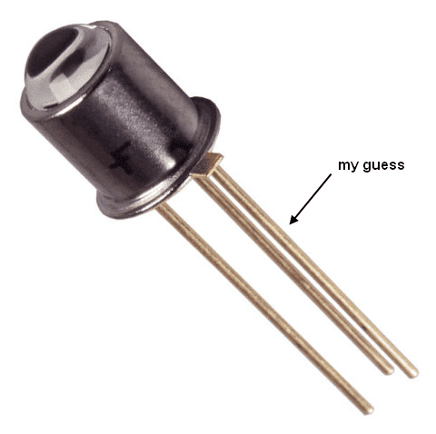

Thanks. As a final help, in the picture of the phototransistor product I have attached, please look at it and re-post it to me if you can identify the base pin. I believe it is the pin that juts out a little bit, which should be the base pin (I have marked my guess in the photo attached). If not, I don't mind, a little bit of trial-and error can be done.
By the way, could you tell why the resistor is used in the circuit? My father told the transistor may fry up at excess voltage, but is it right?

Hello Univeruser - here are the answers to your questions:
The base connection is the MIDDLE pin. This is shown on Page1 of the datasheet - is there a problem with the link which I sent earlier? It would be better to avoide trial-and-error, as you might damage the device.
The resistor is required so that, no matter how powerfully the transistor is illuminated, the current cannot become too high. Your father was correct in that without a resistor, the transistor could overheat, as could the LED. The resistor should therefore not be left out.
