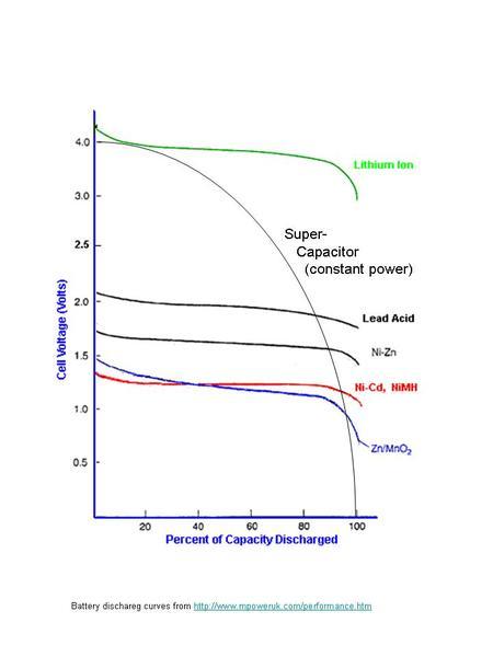

Unlike batteries, which are based on chemical energy storage, supercapacitors store energy using the classic electric capacitance equation E = ½C·V2.
So at constant power, P = -dE/dt = -C·V·dV/dt = constant.
So the equation is quadratic in voltage drop vs. percent of capacity discharged until the battery is completely discharged. The supercapacitor discharge curve is compared to several battery types in the attachment.
Bob S
Yeah, that's just my question, Bob. I don't see how capacitors are any more useful for regenerative braking than batteries unless I'm missing something. They seem even worse for the task with the larger voltage span that needs to be matched with variable breaking power.

Phrak,
I think they use caps for regenerative braking, as they can be charged quickly compared to batteries.
likephysics said:
Phrak,
OK. I don't know who 'they are, but if you dump braking energy into capacitors in a vehicle that is battery powered, what will you do with the energy once the capacitors are charged? Extra systems have to be involved in removing useful energy from the capacitors in parallel with drawing power from the batteries where each are at different voltages. This involves current sharing techniques. It's not out of the question, but it does make power control more complicated. But this is just the beginning.
Secondly, it will do very little good for braking purposes to dump charge into a discharged capacitor. The capacitor represents no load at all when discharged. To be of use, they have to be maintained at some minimum voltage level. An additional constraint on a minimum required voltage is a result of the circuit elements. Power is equal to voltage times current. For a low voltage load, such as a capacitor nearly discharged, the current will have to be high to absorb the same power. There will be some practical upper bound on the current carrying capability of the components charging the capacitors.
There will need to be a back-up system if the capacitors are below some threshold voltage.

Capacitors have some advantages (see https://www.physicsforums.com/showthread.php?t=371697&highlight=super+capacitor) in that they can undergo many cycles and can be made with very low internal resistance. They don't. of course, have a nice steady 12V, like a Lead Acid battery and they need a lot of 'help' from technology - switching circuits etc.. From what I've been reading here and elsewhere, they may well be the way to go. The low operating voltage of present super capacitors limits their application but they are being used successfully even now, in some fields.
Just because of their exponential voltage characteristic, they can't just be written off. I'm almost becoming a convert. . . .
Umm. The voltage characteristics are not exponential but polynomial, isn't it?. But in any case the one and only advantage of these capacitors is the ability to absorb large amounts of braking energy on demand (when not under or over charged). Everything else complicates and adds cost to their advantage.
In the thread you quoted I see the statement "Braking power can easily exceed 150KW;..."
Assuming this number is good, that's a lot of Watts. That's a lot of current, even dumped into a stack of super capacitors precharged to 150V.
Energy dumped into a capacitor of variable voltage by a variable pressure on a brake peddle will need to be modulated to meet the braking needs. This requires regulating circuitry and BIG inductive elements. Inductors are resistive (energy wasters) and big at this power level. This represents a lot of copper, a lot of loss, a lot of weight, and a large up-front cost.
Search the internet. Find me a a toroidal inductor rated at 1000 Amps DC. Is it smaller than a bread basket?
