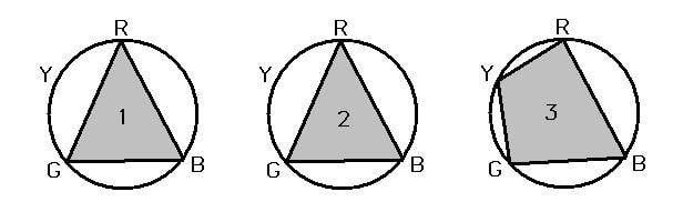

But, if we only have RGB cone cells, then we interpret every color by breaking it down into its R, G, and B components. We therefore could not detect a 100% saturated yellow, because it cannot be expressed completely in RGB components. The color we detect then is less saturated.
I don't deny that an RGBY tv can create more saturated yellows. I'm saying that we wouldn't be able to detect them.
I've made three drawings below. The first is what we can detect, the second is what an RGB tv can create, and the third is what an RGBY tv can create.

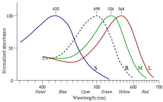

The RGB cones in your eye don't just pick out a specific frequency. There is an entire spectrum of frequencies that each cone will respond to. Some stronger than others.
Similarly, RGB in the TV aren't pure spectral lines either. They are also distributed.
Now, imagine some spectrum p(f). What your eye will see is a set of 3 intensities:
The triangles are definitely not equilateral. Our red and green receptors are very close together, leaving blue (yellow's complement) way out on the edge.

Ok, it was my understanding of cone cells that was flawed. Like K^2 said,
they are triggered by a range of wavelengths, and indeed your green and red cones are highly sensitive to yellow light.
And, yes, my drawings were crude, but my intention was to show that you can't see a color on the edge of the circle (a 100% saturated color) by mixing any two other colors.
The retina is only the input to the visual system, it's not the output. For example, how do your diagrams show the perception of brown or pastel hues?
The point is that perception of color is (at best) loosely related to the spectral sensitivities of the cones.
