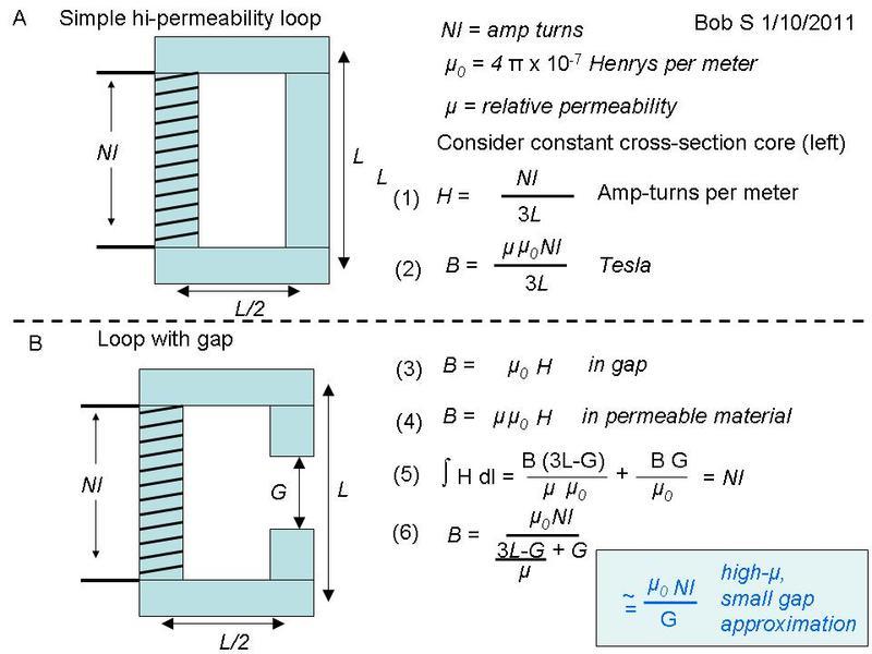

Are you interested in the magnetic field in the gap of a "C" magnet, like in the thumbnail?
Bob S
Now that you ask, I was actually looking into that as well. I was going to end up asking later about other types of electromagnets as well. Because all of the equations I have found have dealt with Solenoids, but now am looking into other types of electromagnets so i don't end up asking this question later on. Do you happen to have equations for various types like the one you have provided?

The magnetic field of a superconducting coil will saturate any iron core. You can easily get B = μ0NI = 3 Tesla in the superconducting coil, but the iron saturates at 1.5 Tesla.
Bob S
