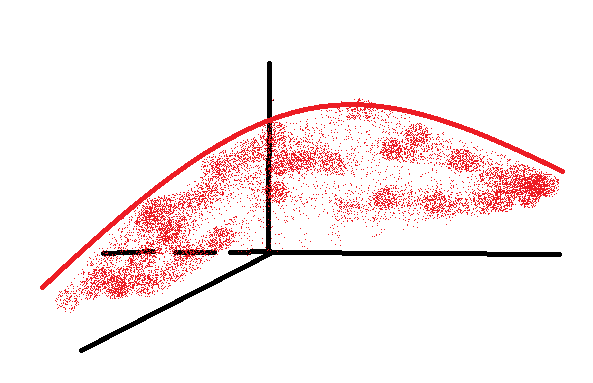

Can i ask what is the area we are referring to when we take such integral (r is the radius):
[tex]\int_{-\infty }^{\infty }e^{-r^{2}}dr[/tex]
I'm suspecting that its is the area of slices of bell curve that rotates about the z-axis.

hi icystrike! :smile:
it's the integral of a vertical slice of the bell curve through its centre :wink:
You understand, I hope, that finding area is one possible application of the integral. When we calculate an integral we are not necessarily finding any area at all!
Thanks tiny-tim and HallsofIvy!
Yes! I know that! We can use Integral to compute things like work, flux, centroids .. =D
Its just that my teacher actually relate the slice as "some slice that is parallel to the y-axis" while i think that it should be the slice that is passing through origin(He've probably made some mistake)... (My teacher was actually comparing the volume of a rotated bell curve about z axis by slice and shells to evaluate the area under bell curve - [tex]A^{2}=\pi[/tex] )
i think he means that it'll be the same (it's the same shape), apart from a factor e-x2 :wink:
Oh! Thats what he meant! Truly enlighten! Thanks Tim! :)
