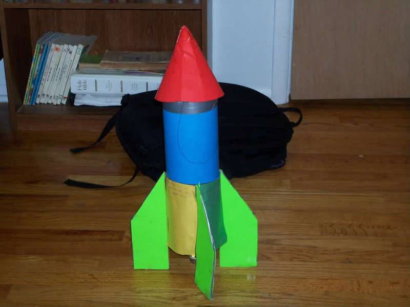

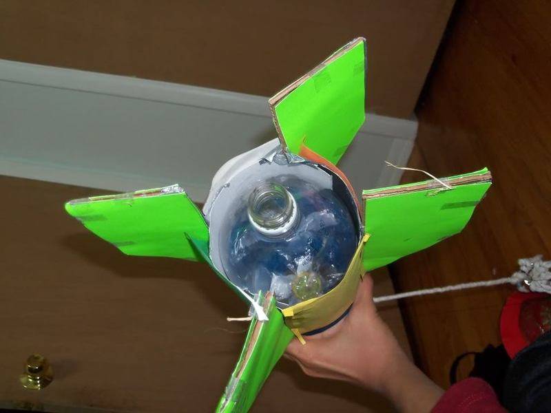

I did a bottle rocket yesterday (2 liter bottle). I made 4 fins and the end of the fins touch the ground instead of the bottle's opening. I also equip my rocket with a parachute (hide under the nose cone). In addition, I added a modeling clay to my nosecone too! When I tested it, my teacher said I should fill a rocket 3/4 with water and pump to 100 psi. I did as he said and my rocket fly short and twisty. My teacher said that I did something wrong with my rocket because it lost the balance when it fly. I have no idea what can I add to my rocket to make it fly straight up (not twisty) and high in the sky.

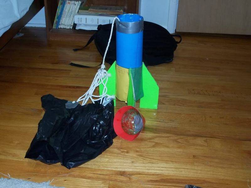

1. Do you think my rocket fly twisty because of 4 fins? I think I should made 3 instead of 4. Also, what is the good material to make rocket's fins (carton, or paper..)? Should I stick the fins at the half of the bottle or near the bottle opening to keep it easily to stand?

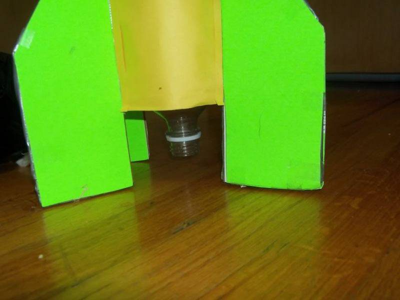

2. I add clay to my nose cone to make it heavier and easier to release the parachute under it. I didn't stick my nosecone to the rocket body but it didn't drop out when it fly to release the parachute. What can I do make my nosecone drop out when it reach the maximum height. My parachute didn't come out, is it because the way i fold it is wrong!

1.Full view
2. Fins touch the ground instead of the bottle's opening:
3.When the nosecone come off the rocket, the parachute release:
4. 4 Fins:
It sounds like your rocket was unstable. For stability, you need a sufficient amount of fin area (4 is better than 3 in this regard, and larger fins are also better), and you also need the center of gravity to be far enough forward. The noseweight helps with this (though too much weight in the nose will hinder altitude, since you're making the rocket heavier). The fins should be as far back as possible, and in the free airstream (not just behind the main bottle). Another key is for the fins to be stiff and solidly attached. If they can just flap around in the airstream, they won't do much to aid stability.
As for pressure and quantity of water? 100PSI and 3/4 full should be pretty good to get close to max altitude, but for test flights, I would go with 40PSI and around half full. That way you can see what's happening a bit better, and it won't have as much energy if something goes wrong. Then, once you get it working, you can ramp up to the 100psi 3/4 full flight.

Your fin area and placement looks fine - I think the problem is the attachment. Fins which can flop around freely provide almost no stabilization. You should really find some way of attaching them more securely. That should probably fix your stabilization problems.
