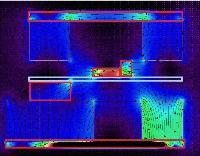

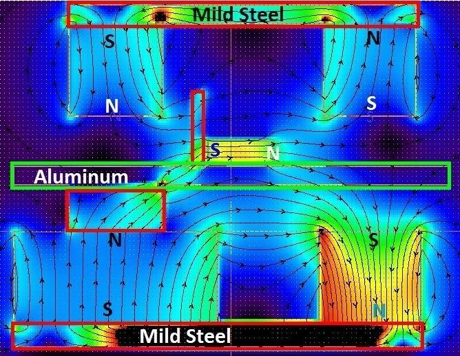

i think i have a way of 'shielding' the coils from the shielding of the base magnets (abit of a convoluted concept) to allow the rotor magnets to influence them more
first, i will be getting a large ring of mild steel which goes over the circle of the large outer magnets, this should 'blend' out the irregularities in the magnetic field which was causing the rotor to 'cog' i.e. there are bumps and pits in the magnetic repulsion due to the gap between the large magnets
then i am going to get a disc-shaped aluminum plate which completely covers the area of the base, and it goes on top of this mild steel ring... on the aluminum plate will be a smaller ring of mild steel as well as 9 bar magnets, forming a 'wall' shielding a region of space above and between the magnets... the coils will then be placed in this region of reduced magnetic field

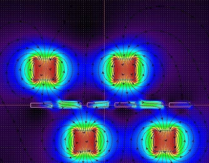

here are 2 pictures I've attached... they show a semi-accurate 'cross section' of the magnetic environment representing the radial components of the magnetic field, and they are showing the left half of the alternator i.e. the left side is the outer side, the right side is the inner side... one picture features the 'ring wall' like i have described, and the other without to show the current magnetic environment that the coils are exposed to
::edit::
it seems that if i replace the magnet with just a simple piece of mild steel, the magnetic void becomes more intense... i have attached a third picture, with the same colour notations , red = mild steel, light blue = aluminum ,but with a new 'wall' position, to show the simulated effect... i forgot which contrast setting i used so pardon the irregularity of the colours, but you can see that the mild steel rectangle in the middle has a much higher concentration of flux relative to the magnet... all the magnets were specified as '1 Tesla' , except the lower right one, which has a value twice as big to approximate how close the inner magnets are to each other
therefore , it seems, i need 3 mild steel rings and one aluminum disc... i do not have the capability to simulate the entire system in 3d, but i hope that the mild steel rings will , in addition to shielding from the radial component of the magnetic fields, also act in an analogous way to the ferromagnetic cores in transformers, i.e. attract and concentrate the magnetic flux lines through the coils... in this case i am hoping that the rings will amplify the tangential component of the magnetic fields

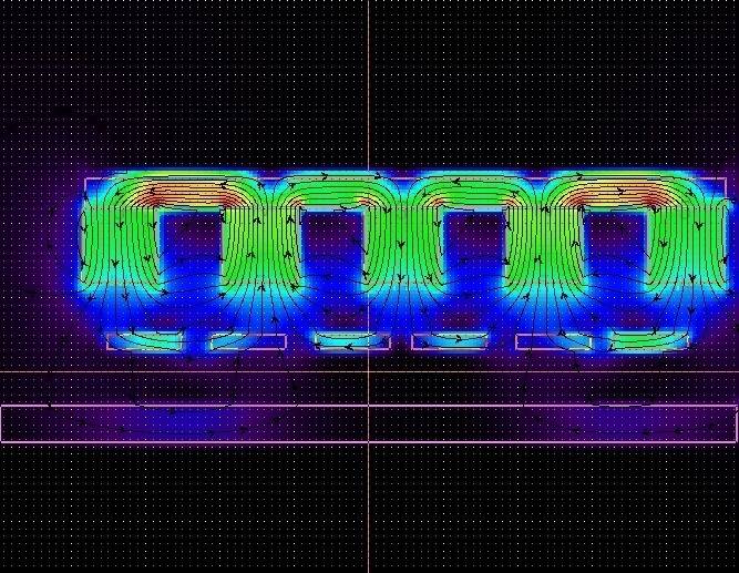

also, it seems that this is one time when the presence of ferromagnetic cores in the coils will be beneficial
attached are 2 pictures...
one is a 'top down' approximation of a section of the rotor, the upper side represents the outer ring of magnets and lower side represents the inner ring of magnets, and how it interacts with discrete pieces of ferromagnetic material placed between them... you can see that the cores make up a 3 phase system, although you can see the simulation isn't perfect because its not an actual ring
also note that the new small rectangular magnets are left out of the simulation- it should be possible to use the lifting magnets by themselves, without any specifically alternating magnet arrangements, to cause a good fluctuation in the magnetic fields experienced by the coils, and generate a voltage that way
the other is a 'side' profile approximation showing the alternating magnets of the rotor at the top, the coil cores in the middle, and the 'shield-shielding ring' at the bottom... as you can see the alternation has negligible effect on the continuous piece of ferromagnetic material at the bottom , and it is mostly on the left and right edges, so if this was an actual ring there should be no magnetic activity in italso i have omitted the 'wall' because it would have also blocked the coils from the influence of the rotor magnetsso to recap... the 'shield-shielding' ring will take care of the radial flux, while the ferromagnetic cores will concentrate the alternating tangential flux into the coils
anyone have anything to say?

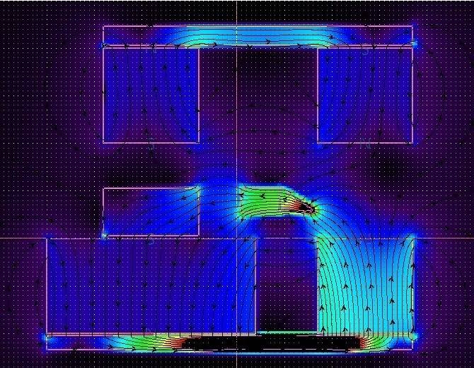

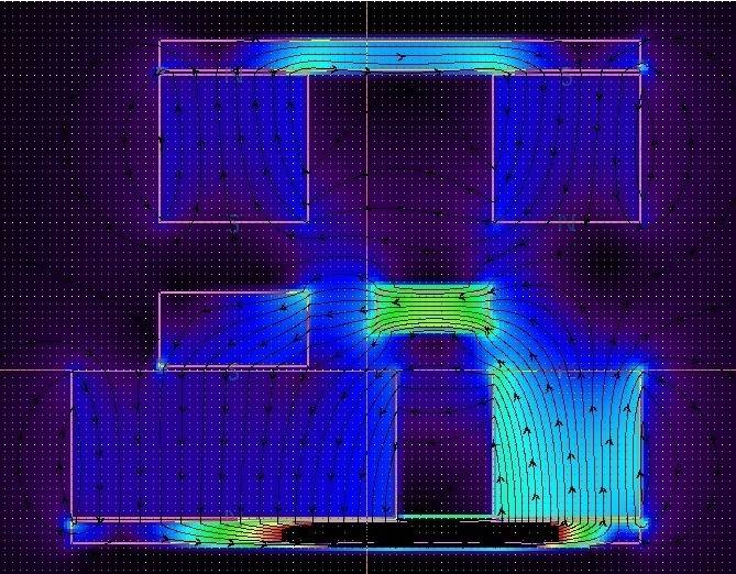

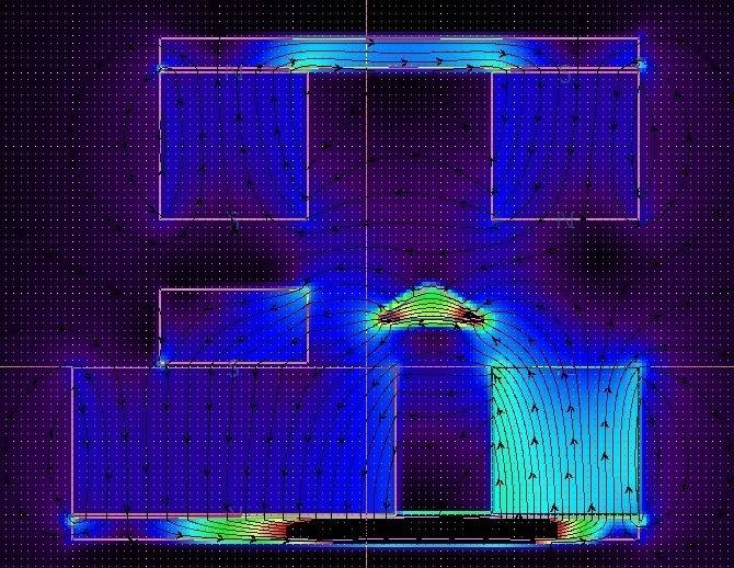

simulating different shapes of the middle mild steel ring
the ring is laser cut from a flat sheet of metal, so it will look like a rectangle in its cross section
but i can use a Dremel to file down the edges and create a slope, and the top of the alternator's rotor can be used as a platform for the ring to spin around as i work on it, so that the slope can be made uniform across the whole ring
the positions of the magnets have also been updated to match their radius positions on the base and the rotor, the aluminum plate has been omitted, but i have moved the middle ring to the bottom side of the aluminum plate
due to the inner diameter of the ring, if it is left in its original rectangular profile, it creates a large interference on the repulsion , especially of the inner magnets, and there will be a siginificant drop in the lifting ability
so by creating a slope which 'points at' the lower inner magnet (because that magnet is the closest), it presents the least surface area for the flux lines to enter, and it no longer causes a major interference to the repulstion
if i also slope the outer edge of the ring and give it a triangle cross section, it will also capture less flux from the rotor as you can see from the higher flux density in upper region... as the rotor's magnetic field is alternating, this should mean that the coils are exposed to more fluctuation from the rotor
the precise shape of the triangle can almost certainly be optimized to give more lift and more power output, but because i do not have the tools or the means to precisely work on the ring, i will just keep it simple and make it symmetrical
