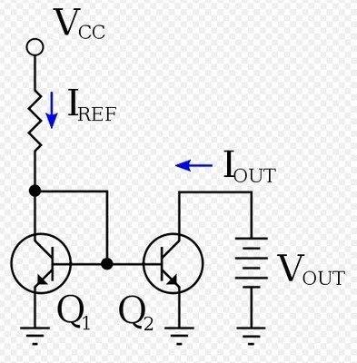

Attached is an image of a typical BJT current mirror. The reference current is established by the resistor.
We can calculate R with: R = (V.CC - V.BE) / I.REF
Now what I don't understand:
I know I.C = I.S * e ^ (V.BE / V.T). The collector current is quite sensitive to changes in the base-emitter voltage yes? Then why is it I'm able to choose the almost arbitrary value of 0.7V for V.BE and end up with the calculated reference current?
Could explain to me how the circuit ends up with a precise V.BE (causing the correct current to flow through Q1 and Q2) despite our rough calculations? Or maybe my whole thought process is wrong, I'm not really sure at this point.

Ib = Is exp(Vbe/Vt)
Iref1 = Ic + Ib = (beta + 1) Is exp (Vbe/Vt)
Iref2 = Ic = beta Is exp (Vbe/Vt)
So Iref2 = Iref1 when beta >> 1
Vbe may not be exactly 0.7V. The important thing is whatever is Vbe for Q1 is Vbe for Q2

If Vcc is >> Vbe, then an inaccuracy of 0.1 volt or so in the value used for Vbe won't have much percentage effect on the difference (Vcc - Vbe).

This is a very typical circuit used in integrated circuits to set up constant current sources. The point is not to get precise Iref, the point is to set up current sources that is proportion to Iref.
You are right, Vbe is not exactly 0.7V, it's only an approximation for calculation. If Vcc is 10V, Iref=(10-Vbe)/R. error is very small if Vbe is off by 0.1V. But yes, if Vcc is low like 2V, the error is much larger. But in the whole picture, it is not important. You should never rely on absolute value on the design.
In fact inside IC, the absolute value of the R is the biggest error. In my days of designing BJT ICs, the resistor is accurate to only 30% ei. if you say 1K, one run can be as low as 700Ω and the next run can be 1.3K! That is where the error really started. Vbe is never even a concern in real life.
Now in addition to your question. This current mirror work only in IC where you can control the dimension of the transistor and design so the two transistors are right next to each other and at the same direction. This will make their characteristics very close and their temperature is closely tracked. You can get good current ratio out of this design. But still if you want precision current mirror, you are going to use emitter resistors. Now you must question about the 30% accuracy of the resistors! The answer is the resistors are not accurate, BUT they can be made to track and proportion with each other very precise. You layout the two resistors right next to each other to get a very tight match with each other much more so if you use two discrete 0.5% resistors.
In IC design, it is only about ratio, not about absolute. That's the reason why you see the power supply current has a large range. Look at the data sheet of opamp, they always spec typical say 1mA, but always spec max of something like 2mA or worst. That's mostly because of the 30% error of the resistors when setting up the current mirror.

so if the two [strike]transistors[/strike] eb junctions are matched, having same doping and construction
and are at same temperature, maybe even both on same silicon die
and they have same voltage across them, their currents will match.
Everything except voltage and temperature is an established physical constant.

My initial problem was when I first looked at this circuit, I was under the impression transistors could only amplify base currents, as in Ic = beta Ib. So I wondered how did Q1 know how much base current to pull? After some studying I realized that as long as the eb junction is forward biased, a base current will automatically flow that is proportional to the collector current which has been established by our resistor. (Correct?)
But then what didn't make sense is what I posted, to do with how Vbe is established. My basic thought was Vbe establishes Ib and not the other way around.
What I've come up with is for Q1: Ic (~Iref) causes Ib which establishes a specific Vbe which is then of course applied across the e-b junction of Q2 causing the same Ib to flow into Q2. Yes/no?
Q1 has the base and collect shorted, it is connected as a diode. In this case, all I care is Ie=Ic + Ib. That is the current that mirror to Q2. Yes Ic=βIb. So if you assume Vbe is 0.7V, then you can calculate Ie=(Vcc-Vbe)/R. The formula for Vbe is

Not really, it is the Vbe matching that matter. In IC, if the two transistor are matched, If you draw Iref and Vbe of Q1 is certain amount, if you put that voltage across Vbe of Q2, you will make Q2 sink Iref if Q1 and Q2 is exactly the same size and dimension. In fact for precision current mirror, we put another transistor Q3 with the base at collector of Q1, base of Q1 no longer connect to the collector. Q3 emitter the emitter drive the base of both Q1 and Q2. With this, we don't even care about the base current as it is buffered by Q3. We only worry about the Vbe.
See, If you want to fix Iref you can only control two parameters R and Vbe (Your Vcc is fixed by power supply.) Again, Vbe in turns depends on Ib and Ic is related to Ib. Thus Iref is a function of Ib and Ic or simply Ib. So,

The very, very simplest explanation about the Vbe: there is a KVL loop that assures the Vbe must be the same. Nothing more is required to explain it.
The other issue, however, is whether the transistors are "well matched" in performance which can introduce errors in the mirroring.
