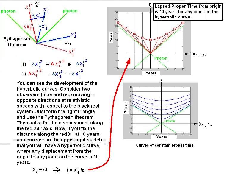

Here are three different frames showing relationship to the hyperbolic calibration curves. I'm showing the event labled "NOW" for each observer such that each observer is located on the same hyperbolic curve (same proper time). Notice that the simlultaneous X1 space for each observer is a line tangent to the hyperbolic curve. So, you can see how the projections from frame to frame give the time dilations.

I think it's easier to see the time dilations using a symetric space-time diagram. Have two observers moving in opposite directions with the same speed relative to a rest frame as shown in the diagram below. Then you can see the derivation of the hyperbolic calibration curves.
