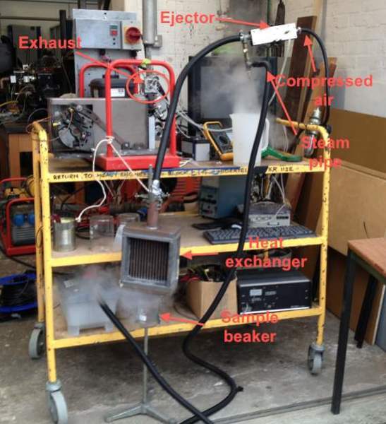

I'm doing an experiment and I'm using wallpaper stripper as my steam generator. So in the end of the experiment, i want to turn the steam into water and I'm having difficulty on this.
I tried to release the steam into the atmosphere but it didn't condense that much. The steam is disappearing in the atmosphere. Also i tried to make my pipe longer but it didn't work as well.
So what i want is a process that condenses steam to water.
thanks xxChrisxx ,,
For cooling it down i used steam hear exchanger coil and i gave it some cold air through a fan. But the result was still the same. not enough water.
i'll try to increase the pressure on my pipe but what is the best way to do that!? As i have 3m long pipe.
Is there any device that can increase my pipe pressure or a away?

I'm doing an experiment to capture the soot from exhaust pipe using steam method.
So what i want a sample of liquid that has steam and soot. All my experiment process is going well only the part of changing the state from vapour to liquid. And I reduced the soot temperature to 100C which also mixed with steam. Only when i release it to atmo it gose and i won't get that much of liquid.
release it into a collection chamber that's kept cold- an Erlenmeyer flask, maybe
how much water are you boiling into steam ?
You can't condense any more than that.
A 1500 watt wallpaper stripper might boil about 1/2 gallon per hour. What power is yours?
Your heat exchanger will have to handle that 1500 watts which means it'll probably need water cooling. Could you surround your condensing pipe with a larger pipe that's kept full of cool water?

I'm boiling around 2 litres and my wallpaper stripper power is 2000 watts but i can control the power.
I don't think so i have this kind of pipe which keeps the cool water. But What i am thinking is to surround my pipe with an ice and that might do the same think.

i'm using compressed air as well. See the attached file and u can see how the experiment looks like.
you can see from the pic compressed air going into the ejector and also the exhaust gas. When they release form the ejector the steam will be joined and mixed.
Then the soot with steam are going into the heat exchanger.
The reason that i have tube underneath the steam pipe end because I'm having some water coming out from wallpaper stripper.
My aim from this experiment is to capture the particulate matters and measure them by using different measuring methods.
I'm investigating the particulate matter.
So any better ideas for the cooling part :D

This remains a mystery! Why is there soot in the steam? How and why something got to where it is is usually significant in figuring a method to remove it.
The soot is from combustion of the engine, being captured by the steam in order to filter it out.
Maybe take a look at this: http://upload.wikimedia.org/wikipedia/commons/8/8b/Surface_Condenser.png
It runs cold water through and the steam condenses on the cold pipes inside. Pretty much how an air conditioner makes so much liquid- water vapour is chilled on the coils and condenses to liquid.
Interesting setup, but I am still confused as to how it works?
