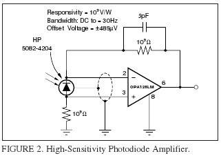

Here is an application bulletin from Burr Brown, a manufacturer of very high quality op amps. You might try some of the ideas in it.
Thanks, that's certainly of use.

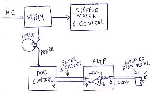

Noise is a problem.
On a breadboard with 50 MΩ (5x10M) and 10pF there is no detectable noise.
But for real, with almost a meter long leads there is noise.
Adding 100Ω in series near the amp didn't help.
In the dark the noise looks like this (FFT at the output, 0-100Hz):
Does this look familiar?
Any ideas how to fix it?
Also, I've never worked with resistance this high before - anything to be aware of? Like leakage across a moisture film along the board or something?
With leads a meter long, are you using shielded cable? In the Burr Brown Bulletin, the oval loop tied to ground represents shielded cable.

You are picking up noise on the long input wires. Look into what Skeptic2 suggested.
As for resistance, don't be afraid, it's just a resistor. I gave you the hint that you need long body resistor. When I did the transimpedance amp with high value resistor, I used DIP package and I bent the -ve input up and solder the resistor on the pin up in the air. You need very good cleaning spray, compressed air to blow away the solvent right after cleaning. 1G is not that high, you do this, you'll likely be fine.
If you measure down to pA, watch out for vibration. I worked on Mass Spectrometers and the vibration from the turbo pumps introduce vibration noise. We end up using rigid coax for input and mount the amp on the frame to lower the vibration to the amp.

The most annoying part is a ~2-4Hz regular-looking oscillation, with up to +-0.5V of amplitude at output. That one happens on a breadboard as well, with no extra wires.

First things first- your diode in the schematic looks reversed. If you are using a one-sided supply this will give erratic results.
The diode is in the correct orientation. This circuit diagram came from the Application Bulletin - DESIGNING PHOTODIODE AMPLIFIER CIRCUITS WITH OPA128 that skeptic2 provided in post #5.
Note also that it's a "one-sided" supply.
I've mentioned it somewhere in the thread- it should have been drawn other way around.
I'm using it in photovoltaic mode, not backwards.

I just have time to take a quick look only. This really bring the meaning of one picture speak a thousand words. The first and fatal problem is you did not use a board with ground plane. You need to have a shielded cable from the PD all the way to the ground plane on the board and ground the shield on the amp board. BUT don't ground or even touch the shield on the ground on PD side. I can't see you stepper motor control boards, but don't look like you are using ground plane either. This will also cause noise to emitted out. Always use ground planed boards. When you do pcb, make sure you use ground plane. For simple amp circuit like this, I can easily do it on a two sided pcb so it will be cheaper.
If you have a torroid, put at the power feed to the board and one on the output wires. This will get rid of some noise if it comes in from the output line or the power line.
This is the general bandaid first. I am not surprised you pick up so much noise looking at the picture.
We literally have a metal box for the amp alone. Stepper motor is very noisy!
To be honest, if you have a cable to the PD, and your circuit is so small, I would really consider putting the amp board right on the place with the PD and just have the power feed and the output line running out.
Now you getting to problem that there usually no one magic fix. It is more step by step working on the ground and shielding. Looks like you have a lot of space to mount the board right on where the PD is. You can make the board very small, the size mainly governed by the size of the 2G resistor. Also, I don't see any capacitor on from the power to ground of the op-amp.
So far i gather that most of the noise is RF - running the stepper from a separate power supply does not reduce it noticeably.
I've put the choke on them - three wraps around a 2cm ferrite torroid - no noticeable effect.
