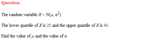

Question 1:
Working:
Now the answer for sigma i got correct, but μ i got incorrect for some reason. Could anyone explain where I've gone wrong for μ?

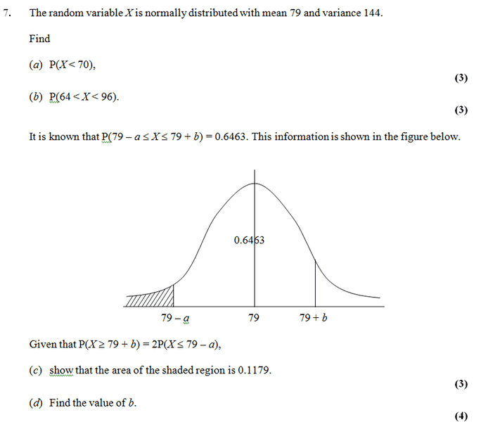

Question 2:
Workings:
All i need help is with part c and d:
for c) i done 1 - 0.6463 to get the probability of the two shaded bits, but where do i go to get the part they are asking for?
for d) i have no idea, any help would be great.

Well, one obvious error is that you have both [itex](25-\mu)/\sigma[/itex] and [itex](64-\mu)/\sigma[/itex] equal to -0.67. One of them should be positive. In any case, the normal distribution is symmertric so it should be clear that the mean will be exactly between the two "quartiles".
The two shaded bits? I assume you mean the one shaded bit and the other outlieing area. That, of course, is 1- .6463. To find the two parts separately, use the fact, as you are given, that upper piece has twice the area of the lower piece.

for question 1) Why is one of the positive (the second one) if they are symmetrical. Also how can i use use symmetry to find the mean? Is it 25+45 / 2?

Is it 25+45 / 2? Close, but not quite: it IS (25 + 45)/2---what you wrote is 25 + 22.5. Brackets matter!

Could you explain why it is (25 + 45) / 2? I don't understand how the symmetry makes this true.
The distance between the mean and the 25th percentile is the same as the distance between the mean and the 75th percentile, because of symmetry. Therefore, the mean is the average of the 25th and 75th percentiles.

for c i done (1-0.6463)/3 as there is 3 parts, with the shaded region being the smallest, which gets me the correct value.
For D I've standardized it but I'm not sure what value i should put it against...

Thank you for all the help, i done question 2 part d also.
