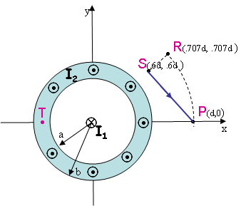

A solid cylindrical conducting shell of inner radius a = 5.3 cm and outer radius b = 7.9 cm has its axis aligned with the z-axis as shown. It carries a uniformly distributed current I2 = 7.1 A in the positive z-direction. An infinite conducting wire is located along the z-axis and carries a current I1 = 2.7 A in the negative z-direction.
What is [itex]\int[/itex][itex]^{P}_{S}[/itex] [itex]\vec{B}[/itex] . [itex]\vec{dL}[/itex], where the integral is taken on the straight line path from point S to point P as shown?
Link to the picture: http://i89.photobucket.com/albums/k211/diethaltao/h15_cylindersD.png
I'm not even sure how to approach this problem. At first I found the difference between the values of the magnetic field at P and at S, but this was wrong.
Then I thought to use
∫[itex]\vec{B}[/itex] . [itex]\vec{dL}[/itex] = μoI
but B is not constant over the interval [S,P] so I can't pull it out of the integral.
I was able to calculate the integral along the dotted path in the picture, which I basically did by realizing R to S was perpendicular to the field so it didn't count, and that P to R was 1/8 of a larger circle drawn around the diagram. But in this case, B was a constant distance from the centre.
Any input is appreciate. Thanks!
hi diethaltao! :smile:
how about doing it along a path 8 times as long, in a square? :wink:

why do you want to know the field?
try using the Ampere-Maxwell law :wink:

Ampere-Maxwell's law says that [itex]\vec{B}[/itex].[itex]\vec{dL}[/itex] around a closed loop is proportional to the current enclosed in that loop, or
[itex]\oint[/itex][itex]\vec{B}[/itex].[itex]\vec{dL}[/itex] = μo*Ienc.
But I can't just plug in the values of μo and Ienc to solve for the integral. And if I choose a square to be my enclosed area, B wouldn't be the same along the side, correct? For example, the field at point S would be stronger than at point P.

yes, but if eg you extend PS to a point T on the y axis,
then ∫ B.dl along PS will be the same as ∫ B.dl along ST, won't it? :wink:

So now I have something like the picture attached, where R is the hypotenuse of a 0.21 by 0.21 triangle (not sure if I need that value, but I calculated it anyways.)
The integral from P to S is the same as the integral of T to S.
And therefore, the integral from P to T would be the same as it would be for the other three sides of the square.
I tried integrating around the whole square and dividing it by 8, but that was incorrect.

use the Ampere-Maxwell law
∫ B.dl = … ? :smile:
Oh, wow, I get it now.
Can't believe I overlooked something so simple! Thanks so much! :smile:
