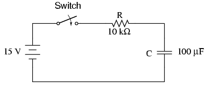

Ok so I have some topic overview questions. I think I am on the right track but would like to make sure I am thinking about this the correct way.
When I say time variant I simply mean there is a simple switch in the circuit. This is link to a were I found my supplemental material and it has a switch like I am talking about. http://www.allaboutcircuits.com/vol_1/chpt_16/2.html
Question 1:
Under what conditions does a Capacitor act like (A) an open circuit? (B) a short circuit? (C) a voltage source?
Question 2:
Under what conditions does an Inductor act like (A) a short circuit? (B) an open circuit? (C) a current source?

3) How do you find y(0+) for a capacitor?
4) How do you find y(0+) for current through an inductor?
5) How do you find y(0+) for voltage on a resistor?
6) How do you find y(∞)?
I do not know the answer to 3-6. I am obviously kind of confused when it comes to the addition of the on/off switch into the circuit network.
HELP on the 0+, 0- and ∞ times would be great!

Draw a circuit with a battery source and a capacitor and resistor in series.. Find the current at steady state...W=0 in a battery...so you have infinite resistance across capacitor at steady state. Voltage across cap will equal battery since there is no voltage drop across resistor.
Draw same circuit with inductor and resistor in series. W=0 in battery...zero resistance...short circuit. Zero voltage across inductor...voltage across resistor will equal your battery.

for that circuit, imagine that the capacitor is fully discharged.
Q=VC says that the voltage across a discharged capacitor is zero, and since the switch is open no current flows, so no voltage across R. when the switch is closed, at t=0 there's now 15V across R and C, but no charge has built up in C, so it must all be across R.
its at this point that C acts like a short circuit, and I flows through R to satisfy ohms law.
that current charges C, so over time a V builds across the capacitor. note that this voltage counteracts the supply voltage, and V across R is reduced, consequently I is reduced, and the rate that the capacitor charges is reduced. this is the i(t) = C*dv/dt differential equation.
after a long time I is (almost) 0. this happens when the capacitor has enough charge that
the voltage matches the supply voltage. at this point, there is no voltage across the resistor, so no current flows. at this point the Capacitor acts like an open circuit.
