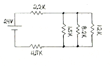

When calculating wattage rating, if you have resistors in both a series and in parallel circuits can you still use P = V2/R to solve for the wattage rating over each resistor if you're given the voltage of the battery or do you have to calculate the voltage drop after each resistor in order to find the next resistor watt rating?
Say I'm given a 24 V battery with a series resistor and two resistors that are in parallel with the series. The series resistor is of 6.9 Ω resistance and the parallel circuits have 1.5 Ω and 8.2 Ω resistance. To find the watt rating of the series resistor the equation it would be P = 242/6.9 Ω. However when you get to the parallel resistors, would you have the equation P2 = 242/1.5Ω or would you have to calculate the voltage drop after the first resistor and use it for the parallel resistor equation?

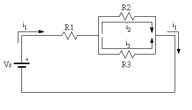

You can certainly use current. In fact, for a given resistance the power is also P = I2R. But again, you'll need to find the current passing through each resistor. This is easy for series connected resistances, but currents divide through parallel paths so that if you have a single resistor followed by a parallel pair, they will not all have the same current flowing through them.

That's pretty much the problem we're given in that picture you just posted. So the best way to go about this is to find the voltage drop after each resistor and then use that drop to find the next rating?

Something in your wording suggests that you're thinking that a 'previous' voltage drop applies to the power consumed by the 'next' resistor in line. This is not the case. The voltage drop you want is the drop across the particular resistor itself.
For the pictured circuit you may employ several methods to find the individual currents or voltages. If the circuit describes your problem, then why not assign the corresponding values to R1, R2, and R3, and make an attempt at determining the parameters?

There are various approaches (which I'm sure you will learn about eventually), but one approach is to first combine the two parallel resistors into a single resistance value (symbolically, R2||R3, that is R2 in parallel with R3). With that 'equivalent resistance' in hand you can then find the voltage drops across R1 and the combined resistance (since the combined resistance is in series with R1). With the voltage across the parallel pair you can use the voltage form for the power equation on the individual resistor values, or use Ohm's law to find the individual currents.

Ok so I attached a copy of the take home test I've been working on. We are allowed to consult outside sources and work with any other student but for clarity I need you to see the picture of the problem I'm working on it's number 6.
To find the quivalent resistance of the parallel resistors it would be 1/(1500 + 8200 + 12000 ohms) correct? The equivalent resistance I got was 4.6 x 10^-5

So here's the picture:
Not quite. The equivalent resistance of parallel resistances is the reciprocal of the sum of reciprocals:
$$R_p = \frac{1}{\frac{1}{R_1}+\frac{1}{R_2}+...+\frac{1}{R_n}}$$
Once you have that equivalent resistance, you can work out the total series resistance presented to the 24V source, and then the current it will be providing.

So Rp = 1.15Ω?
Then that number is add to 2.2 and 4.7 to get Rtotal which is equal to 8.1?
then from there you can find the current from I = V/R? which I got to equal 2.96A
nyxsilverjk said:
So Rp = 1.15Ω?
Yes. You should keep a couple of extra decimal places in your intermediate values, and always carry the units, so 8.047 kΩ would be a better value :smile:
then from there you can find the current from I = V/R? which I got to equal 2.96A? or do I have to convert to K ohms to ohms?
You need to be careful about the decimal place, so if you specify your resistance in kΩ your result will be in milliamps (mA). If you convert to Ohms first, the result will be in amps. It's probably simpler if you work in base units at this stage, so convert resistances to Ohms for your calculations.

It's ok if you can't tell me. But here's my answers going in order from left to right the last one is the bottom left resistor. 19.28 W , 8.64 W , 1.59 W , 1.08 W , 41.18 W
Your values are all three orders of magnitude too high, so it looks as though you used kΩ as though they were Ω. Remember, a kΩ is 1000Ω. Also, the values are close but are not precise. Did you keep enough digits in intermediate values?

I went back and did the entire thing and kept my placing past the thousandths. I also did convert my k ohms and m amps. Then two other students and I compared answers and discussed them, we all came to the same consensus. I'm going to my teacher tomorrow during study hall to confirm some minor questions on syntax.
Thank you so much for helping me with this problem, it's greatly appreciated!
