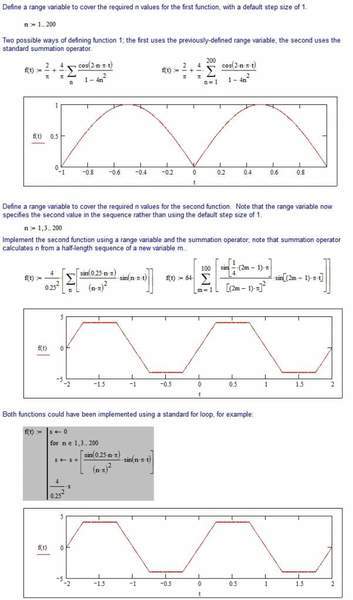

I am going to plot two series in Matlab. They are as following. please help me to write the appropriate code for them:
1-f(t)=(2/pi)+(4/pi)*Ʃ(1/(1-4*n^2))*cos(2*n*pi*t) -1≤t≤1 n=1 forN=200
2-f(t)=(4/0.25^2)*Ʃ(sin(0.25*n*pi)/(n*pi)^2)*sin(n*pi*t) -2≤t≤2 n=1,3,5 forN=200

You want to construct a vector for n, the use that and your formula to compute a vector of each element in the series.
The complication appears to be that you have two variables: n and t.
So you'll probably have to construct vectors for the different frequencies as well as the coefficients ... with the aim of ending up with a 2D matrix whose columns are the elements of the sum (corresponding to each n) and the rows are the functions at discrete samples (corresponding to values of t).
Summing the columns provides a row vector whose entries are f(t) sampled for discrete values of t. Then you can plot(t,f).

Well, here's how it might be done in Mathcad.
I have gut feeling (a colon sensation, one might say) that there is sum way of doing a similar thing in Matlab. I have a forboding that loops may occur to somebody, but they should probably be avoided.

What exact steps you use are up to you - I have not suggested any exact code, just the mathematical structures you'd need to employ.
Technically you don't even need a 2D matrix to store all the terms, you could use a different 1D vector for each of the 200 terms instead. The approach outlines is a "brute force" method - there will be more elegant approaches.
Note: for the second one where n=1,3,5...200 (or is it n=1,3,5...399 for N=200 terms?)
Anyway = in MATLAB you need only do the step, so all the odd numbers are n=1:2:199; for all the odd numbers from 1 to 200. Writing it out in sigma notation is trickier than that... I need to sum over integer m from 0 to 99 and n=2m+1 and it looks like:[tex]f(t)=64\sum_{n=1}^{200} \sin\left ( \frac{(2n-1)\pi}{4}\right ) \frac{\sin((2n-1)\pi t)}{((2n-1)\pi)^2}[/tex]... for the first 200 odd numbers.
[One way matlab/octave is easier than pencil and paper :) ]
Note - the mathcad notes look like what I was suggesting only using jargon.
