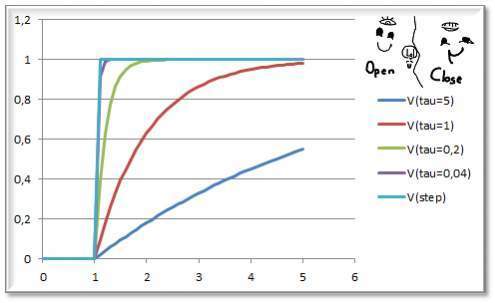

If you charge a capacitor through a smaller and smaller resistor, you'll get something like this.
The curve comes closer and closer to a so called step response.
When we consider ideal wires, an ideal capacitor, an ideal constant voltage source, and an ideal switch, the graph will ideally be a step response.
But you're right, that's not realistic!
It's just an ideal and abstract approximation of reality.
(There! I included a smiley!)
