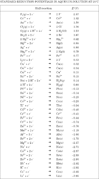

The theoretical limit of batteries is more or less determined by the first and second laws of thermodynamics. That is, the relationship between the change in gibbs free energy for each half cell reaction and the molecular weight of the active species involved in the reaction.
To understand these relationships more simply, just look at the periodic table. In a nutshell, you want your negative electrode to be an element farthest to the left (for greatest activity) and the positive material to be an element farthest from the right (except for noble gases). And you want both materials to as closest to the top (least density). To see this more clearly, look at a Standard Reaction Table (below). You can see that the greatest cell potential (and therefore energy) comes from Lithium and Fluorine. This is about as a good of a battery as you're ever going to get. But obviously, building a battery like this is a huge engineering challenge. Not only is Li metal hard to contain and work with but F is obviously gaseous and tends to react with everything.
But there's a lot more to obtaining high energy density than just active materials. Packaging, electrolytes, separators, and containment, are all factors which greatly influence a battery's energy density. As for today's technology, most people are looking at using Li-Air and Zn-Air batteries for achieving energy densities of up to ~400Wh/kg. In a nutshell, with this design you only carry the anode of the battery and let your cathode be oxygen in the air so theoretically you can cut your battery weight in half.
