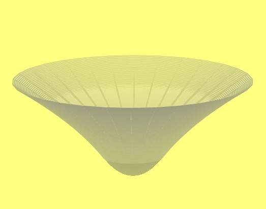

Here the exterior and interior spatial Schwarzschild geometry combined:
From: http://de.wikipedia.org/wiki/Schwarzschild-Metrik#Vollst.C3.A4ndige_Schwarzschild-L.C3.B6sung
I see how the surface θ=π/2, t=constant should have been a flat plane in flat spacetime but it's a paraboloid in Schwarzschild spacetime. What happens at r=rs? Flamm's paraboloid only depicts the non-Euclidean equatorial plane. Is there nothing that can be done to show the curvature of all such planes(entire space)?

I'm not sure whether you have grasped the point that the diagrams in post #6 represent the geometry of a 2D slice of 3D space around a black hole (Flamm's paraboloid) or a star/planet (the yellow diagram). If you were near the planet you would perceive the "slice" as a flat plane, but if you measured the geometry of the plane using rulers and protractors, you find the geometry was as if you were on the illustrated curved surface embedded in Euclidean 3D space. In these diagrams, the vertical dimension doesn't represent any direction in 3D space: it's an extra "fictitious" dimension we add to the diagram to illustrate the curvature within the 2D surface.
Thanks. I had been thinking of it as a real dimension.
Why does the paraboloid shown on wiki have an open end? It should be closed like the one in post #6.
The one on wiki shows only the exterior Schwarzschild curvature, and the diagram of the exterior solution falls apart at a certain radius. The one here shows the exterior and the interior solution.
I thought I had answered that:
DrGreg said:
The other point is that you can't extend the paraboloid inside the event horizon because we are looking at space from the point of view of an observer who is at rest relative to the black hole. No such observers can exist on or inside the horizon.
