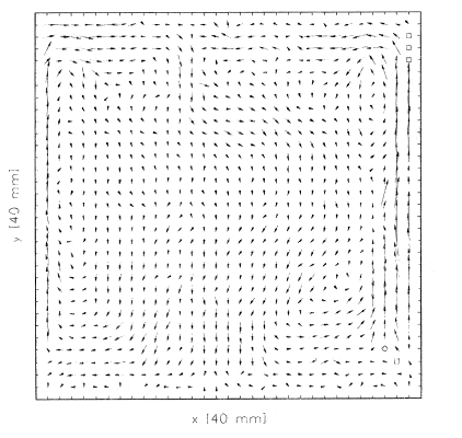

Do anyone have any software by which i can make a vector diagram from a group of points.you can think it like..suppose you have x & y component of a vector at a point..you can draw that easily but i will have to draw a vector diagram for 100 or more points arranged on a surface...i will give the co-ordinate(x,y) of that points and x&y component values of vectors which works at the respective points..as an example...

Thank you Mr. Bill Simpson for your reply. I am attaching files for your consideration. i am wanting this type of figure.

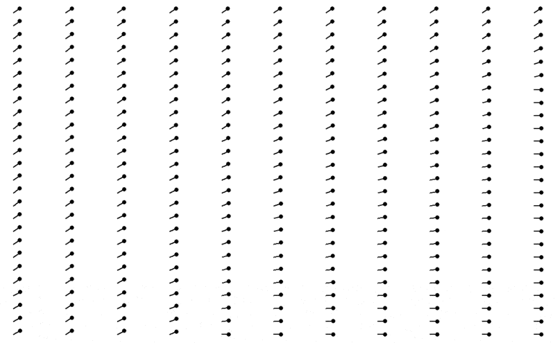

I am guessing about a few things, but here is a quick and dirty Mathematica implementation.
In[1]:= v=Import["Vector Diagram.xls"];
In[2]:= vv=Map[Drop[#,1]&,Drop[v,5]]; (*discard "labels"*)
In[3]:= g=Show[Graphics[Reap[
For[y=5/2,y≥0,y-=1/10,
For[x=0,x≤5,x+=1/2,
mx=2x+1;my=10(5/2-y)+1; (*create suitable subscripts*)
Sow[Line[{{x,y},{x+1/15Cos[vv[[my,mx]]Degree],y+1/15Sin[vv[[my,mx]]Degree]}}]];
Sow[Point[{x+1/15Cos[vv[[my,mx]]Degree],y+1/15Sin[vv[[my,mx]]Degree]}]]
][[2,1]]]]
In[4]:= Export["vectors.gif",g,ImageResolution->300]
Check this carefully before you depend on it

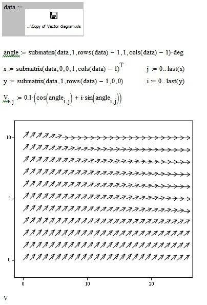

Mathcad is another application that will do what you want.

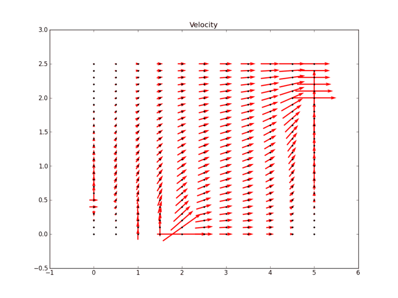

According to your latest excel file where you include separate component for x,y velocity...this is what I get, using python and the pylab module
Code:
from pylab import *
X,Y = meshgrid(arange(0,5.5,0.5), arange(0,2.6,0.1))
U = genfromtxt("vectors-U.txt", dtype=float, delimiter='\t')
V = genfromtxt("vectors-V.txt", dtype=float, delimiter='\t')
figure()
Q = quiver(X,Y,U,V,pivot='mid',color='red',scale=300)
plot(X,Y,'k.')
axis([-1.0,6.0,-0.5,3.0])
title('Velocity')
show()

niloy112 said: "the problem is that I have never used python before"
...I think we all figured that was going to be the problem...not matter whether the solution was given to you in Mathematica, Mathcad, Matlab, Octave, FreeMat, SciLab, etc...do you know any of these?
...so, one way or another, you are going to have to learn something...
As far as your question about using the code after installing the software "will it be o.k.?" I am not sure whether you are asking for permission or asking whether it will work or not...Of course you have permission to use the code and I am sure it will run o.k., too...just make sure you install the pylab module, too.
Thank you "gsal" for your reply. I need one more favor from you that is " Can you please give me the file named 'vectors-U.txt' and 'vectors-V.txt' which you used on your pylab module". Actually i have started to learn PYTHON that is why i am facing problems.
Hoping to get reply from you.
I am not at the computer where I have the files; but, I just simply copied the data from the excel file that you posted into two separate files, one for the x component and another for the y component of velocity...no x-heading row and no y-column, though, just data; the x and y values for the grid I put it together in the python file, as you can see.
By the way, when you pasted the data into excel, you must have messed it a bit...
Dear 'gsal' thank you for your help. I have finally managed to make diagram. Full credit goes to you. I can use now these type of figure on my paper. Again thank you for helping me.One thing more is there any manuel or user file for python user like fortran or C?
Of course there is a manual for python...there are plenty. There is a lot of documentation for Python; depending on what distribution you install, it may come with some docs installed locally...otherwise, you can simply consult the on-line manuals.
There are also many books for python and even free ones like Dive into Python.
Python has come a long way on its own merits and is very big within the scientific and engineering community. It is also becoming the scripting language of choice (for scripts, macros, etc) in other applications whether they are free/open-source and even commercial ones.
Learning python is going to be one the best you will ever do for yourself. :-) Keep it up.
