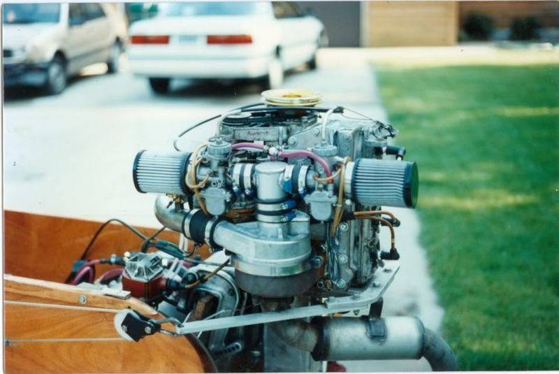

Here is a picture of my first try with a turbo two stroke Mercury four cyl in line. The motor is 44 cu. in. and has an advertised HP of fifty HP, but a dyno shows repeatable and consistent 40-41 Hp in stock form on all of these motors I have tested.
Okay, here's where the mistake comes in about the common notion that a turbo will simply blow through a two stoke without creating boost in the cylinders. I have put a one way reed pressure gauge on a simple two stroke to check only positive crankcase pressure. At high RPM's the positive pressure in the crankcase was about 7.5 psi. The motor was not an expansion chambered motor, but a simple non tuned exhaust system. When the piston is down and both ports are open you have a gradient of 7.5 psi on the transfer or intake and pretty much zero on the exhaust side, so the engine will run fine with the 7.5 psi difference driving the fresh charge in and the exhaust out. For clarity, let's assume we are super charging for a moment. Now let's crank up the crankcase pressure to 27 psi. If the exhaust pressure was still zero, it would work like 99% of people think. Lots of wasted fuel/air blowing through the open exhaust port with minimal HP gains.
Now here's the catch. Let's put a butterfly in the exhaust system near the motor and put a pressure gauge between the exhaust port and the open butterfly. With the motor running as we slowly close the butterfly, a pressure will began to build in the exhaust area. We know if you continue to restrict the exhaust until you have 20 psi, the crankcase will still have 27, for a seven pound difference and the motor will still operate. Now as the piston, on it's upward stroke is just about to close the exhaust port, you will have 20 psi in the cylinder and the exhaust system up to the butterfly or restriction. That's 20 psi boost.
A turbo works like a natural restricter in the exhaust system and puts out more air pressure on the compressor side in psi than it restricts in the exhaust side. On a four stroke, this exhaust pressure is an unfortunate thing, but on a two stroke it is positively needed.
It is said the true boost of a two stroke should be measured between the exhaust port and the turbo because that's the pressure your cylinders will see as the piston closes the exhaust port.
There is another advantage to a turbo'ed two stroke. The pressure that is fed through the crankcase before the reeds, that normally would be bumped up 7.5 psi in the crankcase, is much greater than it normally would be. This is probably due to the fact that the outside boost pressure is feeding the crankcase at piston positions that would not normally draw fuel/air into the case.
As far as working out all the pressures in all the various places like carbs, crankcase and exhaust, the turbo seems to pretty much take care of all of it naturally. My first try of putting a cover over the exhaust side of the motor and slapping a turbo on it, then routing the compressor side back to the crankcase with a carb UPSTREAM of the turbo made over double horsepower on the first try on the dyno.
The process is simple, but there are a few catches. A carb likes to be drawn through, but it also works to blow through the carb, but either the entire carb must be under boost pressure or at minimum, the top of the float bowls must see boost pressure. There are advantages and disadvantages top both methods. Blowing through the carbs means leaving the carbs in stock location but fuel input pressure must be higher than boost pressure, but all this has been worked out by regulator systems. If you draw through the carbs, this puts the carbs quite a distance from the engine, so starting and idling suffer a bit.
I hope I have gotten the concept of the turbo on a two stroke clarified. I've had quite a few racers say that they still don't get after going through everyway possible to explain it. It seems to be a mental block type thing I guess. So, if you see the concept, welcome to the elite 1%!
