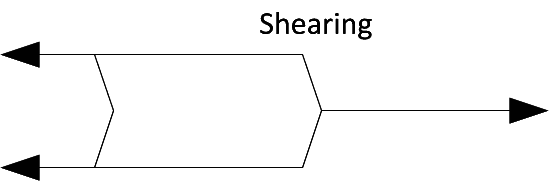

Sorry, but I guess I'll have to explain how you are crazy here. ;)
Ultimately, the object is 3 dimensional.
In particular the force is applied to a point, meaning torsion and shearing do occur.
Let's start with the shearing.
Consider horizontal layers in the object.
If the object is weak enough, you'll pull the middle layer out, while the top and bottom layers remain attached to the wall.
That is shearing.
As for the torsion, consider layers of the object that are above and below the paper.
The force bends the layer in the paper down.
But a layer above the paper is not bent down directly and resists.
This is torsion.

Ahh...so we're also taking into consideration the object is U-shaped. And if it wasn't?
Femme_physics said:
Hmm...
So I presume you're referring to the fact that the object is U-shaped, which you brightly deduced through the drawing and I didn't mention.
No, I wasn't referring to it being U-shaped.
I was assuming it's a block or a screw.
But still...look ->
What's the difference between the tension here and the tension in my example? The welding? The U-shaped? They make all the difference?
It's not regular tension like you are drawing.
Look ->
The forces are not on the same line.
That is why it is shearing.
How is it U-shaped?

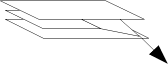

That would be the case if the forces were distributed equally.
In practice it wouldn't bend so nicely and equally.
Applied to your OP drawing, it's more like this ->
Hence, torsion.
So it all comes down to presuppositions. Well, I wish it has been so clear to us in the beginning! I think I can take it from here then :smile: Thanks ILS, and to everyone else replying as well...

In the picture I drew, there is a combination of bending and torsion.
All layers are bent into the direction of the force.
But there is also torsion between the top and middle layer, and reverse torsion between the middle and the bottom layer.
