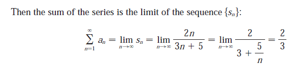

Hi I don't understand the logic in the picture i added. They say that "that sum of the series = the limit of the sequence"
The limit is 2/3 BUT the sum, Ʃ, must be 2*1/(3*1+5) + (2*2/(2*3+5) + 2*3/(2*3+5) ...+
Which is obviously much larger than 2/3 if all the terms are added together?? it's like adding 2/3+2/3+2/3 which is = 6/2 =2??
Is there something I'm misunderstanding here?
what is the a sub n term? the a sub n terms are added together to get the s sub n
the sequence referred to is the s sub n terms as defined by the 2*n/(3*n+5) you don't sum these. Instead you must evaluate the term as n approaches infinity.
so that when n is very large the sequence terms become 2*n / 3*n and the n drops out to leave 2/3

Ahh so the partial sequence of Sn adds up to 2n/(3n+5) as you said (just like 1/2^2 adds up to one). so if we add up all the terms of some imaginary sequence we would get the sum to be 2n/(3n+5), so the sum is the end result and NOT 2*1/(3*1+5) + (2*2/(2*3+5) + 2*3/(2*3+5) ...+ which is the result of adding up the sums.
So the limit is the the sum because the sum is 2n/(3n+5) and when n gets big it's 2/3. Is that correctly understood? And thank you :)
So is it correctly understood that the limit of a sequence 1/2^n is zero but the limit of the partial sums of that sequence is 1? That's the diffrence?
christian0710 said:
Ahh so the partial sequence of Sn [STRIKE]adds [/STRIKE]up to 2n/(3n+5) as you said (just like 1/2^2 adds up to one). so if we add up all the terms of some imaginary sequence we would get the sum to be 2n/(3n+5), so the sum is the end result and NOT 2*1/(3*1+5) + (2*2/(2*3+5) + 2*3/(2*3+5) ...+ which is the result of adding up the sums.
Don't say adds up, its not adding up its a sequence that approaches a limit, the limit is 2/3

With respect to your prior statement, it would be better to say:
partial sum of Sn is given by 2n/(3n+5) and this approaches 2/3 as n approaches infinity.
perhaps we're splitting hairs here but I didn't want you to think that the 2n/(3n+5)
is the same as s1+s2+s3...

I see because you wanted me to understand that 2n/(3n+5) is the infinite series (when n goes to infinity) and s1+s2+s3... is a sequence of numbers.
christian0710 said:
Thank you! :)
The infinite series is
$$ \sum_{n = 1}^{\infty} \frac{2n}{3n + 5}$$
2n/(3n + 5) is merely the n-th term in the series or the n-th term in the sequence that underlies the series.

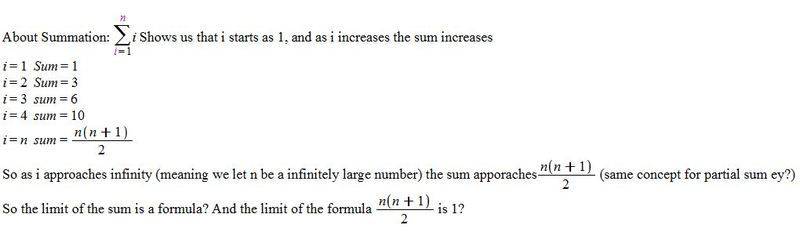

I'm sory, You are right I'm confusing things together. I sat down, re-read everything, and here it is. I understand it now, I really spent time thinking about it.
We have a sequence of number fx the sequence 1/2n, and we can test the limit of such a sequence, by doing this we want to find out what the sequence approaches as n → ∞
Lim1/2n = 0
If we add the terms of an infinite sequence we get what we call an Infinite series. The series is a number/sum denoted Ʃ(an) consisting of the addition of the numbers in the sequence an.
Instead of adding the whole sequence to infinity, we add a part of the sequence. We call this The partial Sums, denoted Sn.
Sn = A1+a2+a3…an(…=infinity)
We can test if this series of numbers converges toward a finite number, or if it diverges to infinity by using partial sum.
Example
If we have a sequence an = 1/2n
The sequence is: 1/2 ,1/4, 1/8…,1/nn...(...= going to infinity)
The limit of the sequence if we let n go toward infinity is Lim 1/2n =0
On the other hand The series Ʃ(1/2n) also has a limit. We can prove this by a rule that says if the Sequece of the partial sum {Sn} is convergent (which it is, because the limit of the sequence {Sn}=1/2 ,1/2+1/4,1/2+1/4+ 1/8…,1/nn is 1} then the series Ʃ(1/2n) is convergent, and it is because it converges toward 1.
You were right, I was confusing the sequence of terms with the sequence of partial sums, that was what confused me so much in my calc book. Thank you! :)

In my book under the phrase "The sum of the series is the limit of the sequence of the partial sums" they show
Ʃan=Lim Ʃai where Ʃai = Sn. How can they take a limit of a sum/series that only goes to n?

Edit: I just added a picture the sum and limit of sum as I understand it, could this be the right way of understanding it?
You're omitting information about the index of the summation, so are obscuring some important information.
Sn = a1 + a2 + ... + an = ## \sum_{i = 1}^n a_i##.
The sum of the series (if such a sum exists) is
$$ \lim_{n \to \infty} S_n = \lim_{n \to \infty} \sum_{i = 1}^n a_i$$
Sn is a function of n. As n gets larger, Sn represents a (finite) sum with more terms.
The sum you show in the picture is a finite sum: 1 + 2 + 3 + ... + n.
The formula n(n + 1)/2 is the sum of the first n integers. It does not represent the sum of an infinite number of integers.
Here's a question you asked in the thing you attached:
And the limit of the formula n(n + 1)/2 is 1?
Does the sequence {1, 3, 6, 10, ...} look like it is approaching 1?
However, the general term in the sequence is 2n−12n, and its limit as n gets large, is 1.
