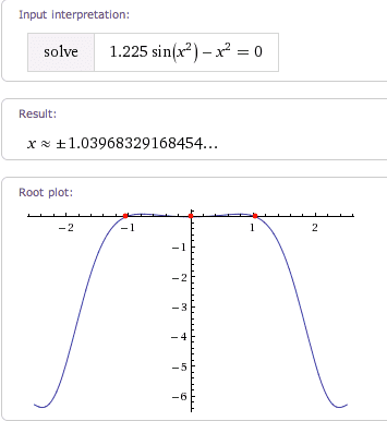

Shoot, I realized that I misstated the problem. It's actually 1.225*sin(t2) - t2 =0
But yeah, I realize that it still doesn't make much sense, but this is the answer and the graph that wolfram alpha spits out, and I'm just trying to figure out how to replicate that either on paper or on my calculator
Why doesn't it make much sense? Your graph clearly shows zeroes near ##\pm 1##. You could work it by hand with your calculator using Newton's method with a starting value of ##x=1##. Make sure your calculator is in radian mode.
LCKurtz said:
Why doesn't it make much sense? Your graph clearly shows zeroes near ##\pm 1##. You could work it by hand with your calculator using Newton's method with a starting value of ##x=1##.Make sure your calculator is in radian mode.
Aaaaand there's my problem. I was doing it in degrees the whole time on my calculator, and couldn't figure out why my graph looked nothing like the wolfram graph. Derp. Thanks!
Common mistake :wink: I've done it enough times myself that it's now on my checklist of things that could have gone wrong.
