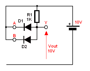

Here's another AND gate.
Here's how I understand this
I don't. Diodes only allow current in one direction so how could this ever produce any output? Or does this work because diodes are imperfect and after a certain threshold voltage they will both allow a current. If so it seems strange that anyone would use this as the diodes are being used someone against their intended purpose.
What's labelled V is supposed to be a constant supply voltage, say +6V. When you apply 0V to the input at one of the diodes, what is the voltage at "out"? When you apply +6V to both diode inputs, what is the voltage at "out"?
Try to look at the diodes as switches.
When they conduct they are closed switches. If you use two level of voltage, 0 volts and V volts, you can get the diodes to conduct when you apply 0 volts to the corresponding terminal.
You then have direct connection to 0 volt potential, that is mass. Output is 0 volts (if the diode is ideal) and resistor R is dissipating the power in the form of heat.
This happens if at least one diode is conducting.
If neither diode is conducting, i.e. their input a both high, no current is flowing through R, hence no voltage can drop across it, and the output is V volts, i.e. high.

In this Diode AND gate circuit we force both A and B into HIGH state.
We have this situation
Both diodes are "OFF". No current flows through R1 resistor. If no current flow through resistor, there is no voltage drop across resistor. So the output voltage is in HIGH state (10V).

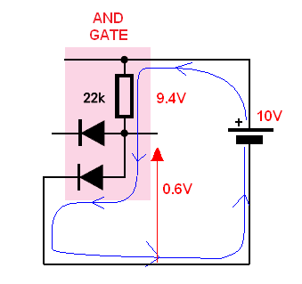

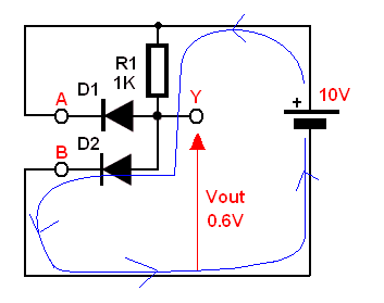

But if for example we have A input at HIGH state and B input at LOW state. D2 diode is forward bias. So there must be a current flow through R1 resistor.
So the Output is at LOW state (0.6V - D2 diode forward voltage drop).

There is voltage at the output when the diodes are both reversed biased. Which will happen if both A and B are high. If either A or B is low a diode conducts, if they are both low both will conduct. But it only takes one diode conducting to "steer" current left and there is less voltage available at the output than Vout(1) (that voltage which corresponds to a logic high).
So - if either of the inputs is low, current is steered left through that diode to ground, there is not adequate voltage at the output to correspond to a logic high.

wannab, think of diodes as one-way valves. if the applied voltage is positive (or exceeds about 0.6 v), it conducts and if the applied voltage is negative, it does not conduct.
