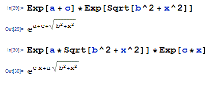

You cannot take e^c out. C is multiplied by the square root, not added. Same for e^a.
You can take out any coefficients. If it were added, it would need to have an x multiplied by it, but if the equation is a monomial, you can take any constant coefficients out of the integral, without affecting the answer.
see the difference:
It's e^c*x, so it's logical to interpret it as "(e^c)*x", instead of what you seem to be doing: "e^(c*x), but I do now see what I did wrong: For some reason I forgot my exponent rules and thought "a^(bc) = (a^b)(a^c), when indeed it does not. Sorry, I may have been previously misunderstanding your point.

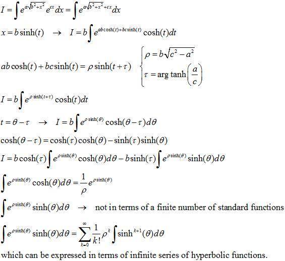

Hi !
Integral of exp[a*sqrt(b^2+x^2)]*exp(c*x)*dx
this integral cannot be expressed in terms of a finite number of standard functions, but in terms of tough series of hyperbolic functions. See attachment.
The formal result will be so ardeous that I doubt that it could be useful for further calculus in practice.
So, I suggest to use numerical methods instead of analytical.

Thanks indeed!
Yes I tried a lot but have not find any good result and you confirmed this. Thanks for your effort, I really appreciate your time! Thanks again.
