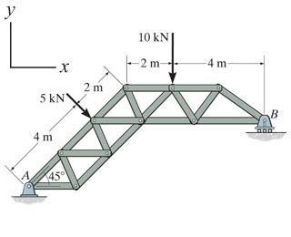

Basic Statics problem, forces on a Truss
The discussion focuses on determining support reactions for a truss structure supported by a pin at point A and a roller at point B. Key equations utilized include the sum of forces along the x-axis and y-axis, as well as the sum of all torques. The forces acting on the truss are simplified for educational purposes, with a 10 kN load representing self-weight and a 5 kN load simulating wind effects. Understanding these forces is crucial for analyzing real-world structures where additional loads such as snow and internal crane loads are present.

The truss is supported by a pin at A and roller at B. Determine the support reactions.
sum of forces along y-axis, sum of forces along x-axis, sum of all torques
Sum of x= Fax+ Fbx+ 5sin45=0
Sum of y=Fay+Fby-10 -5sin45=0
I would like to know how the forces act on the truss, and why. It hasn't been very well explained to me. Thank you : )

In a real structure there would be a lot more forces representing self-weight, snow, wind, loads from internal cranes etc. In this case, which is a 'learning example' you could imagine the 10 kN load as representing the self weight and other permanent loads, and the 5 kN load as a simplified wind load, which, in reality would be a variable distributed load.
