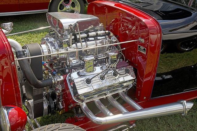

It didnt take hot-rodders long to figure out they could be made quite powerful. This one likely began its life in a 1957 New Yorker.
Hemi heads have been the engine builds choice for years. Chrysler and Ford Hemis rule in drag racing. A circle is the optimum shape for vector resolution
(reacts equally to forces from all directions). Taking this one step further, when you introduce fuel/air mixture in a Hemi sphere combustion chamber and light it, you have uniform burning of the mix and force is applied in the most practical manner. Compare this to the typical wedge combustion chamber design which does not have best flame travel and force is staggered as the mix expands and applies force to the piston surface. Additional advantages are huge valves may be used, and depending upon the design Dual overhead cam design being the best, you can really pack in the mixture.

Yes. The hemi head design allows a much better port to valve design and a permits a central spark plug placement in the cylinder. This permits a very straight port to valve design This design has dominated NHRA top fuel drag racing for the last 50 years.

...a much better port to valve design
translation - streamlined passageways around the valve.
Since the air-fuel mix needn't make an abrupt turn, the engine "breathes" freely.
You can see this on right side of photo.
It helps get a full charge into the cylinder at high power high speed operation.
