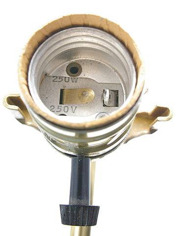

Here's a practical example... in the US this is a common lamp socket.
photo courtesy of: By Hustvedt (Own work) [CC-BY-SA-3.0 (http://creativecommons.org/licenses/by-sa/3.0) or GFDL (http://www.gnu.org/copyleft/fdl.html)] , via Wikimedia Commons
Observe the threaded sleeve into which you screw the lightbulb. It's just inside the cardboard insulator.
That sleeve is connected to the "neutral" wire of the lampcord.
The neutral wire is the conductor with a rib in its insulation. The hot wire is smooth.
The neutral wire is connected to the wider of the two prongs on the plug.
That's so the plug will only go into the receptacle one way, neutral wire in wider slot..
The wider slot in the receptacle is or should be connected to a white conductor inside the wall that is earthed at the house power panel.
The reason you wire the lamp socket/cord/receptacle/panel that way is there's a good chance your fingers will touch the metal threads of the lightbulb while you are installing it.
When they do , you will not get a shock if the house wiring is in good order. That's because the metal sleeve, and hence the metal threads on the bulb, are earthed through the wiring.
If you DO get a shock something needs to be fixed.
I once purchased a cheap lamp that was wired backward - sleeve was hot and the lamp would have been a shock hazard. Nowadays i always check them.
