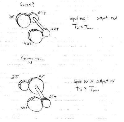

- One participant describes a gear setup involving 40 and 24 teeth gears and expresses concern about insufficient power to close claws when objects are present.
- Another participant suggests increasing the gear ratio to enhance torque, noting that this would lower output RPM while increasing torque.
- A participant questions whether the proposed gear ratio is the best for maximizing power, with some suggesting that using different sized gears could further increase torque.
- There is a discussion about calculating torque required to lift objects at an angle, with one participant explaining the relationship between torque, radius, and force generated.
