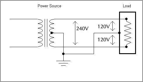

About battery and power grid circuits
In your home, the AC mains use the neutral as a return path in an unbalanced load. There is current flowing through the neutral wire, but it is very slow. An equation factoring in the current, charge of electrons per CC, and wire gauge can calculate the current flowing in a 100watt lightbulb to be about 3 inches per hour. It is slow like molasses.
In North America, your house panel is fed by two 120volt conductors and 1 neutral conductor. To get 120 volts, one of the hot phases is connected through a load back to the neutral conductor. The neutral conductor comes from a center-tapped winding on the secondary side of the distribution transformer. The neutral is earthed at your panel and at the transformer to prevent any situation where the neutral could carry a voltage higher than ground potential. For a 220volt potential, the load is connected between the two 120volt phases which create a 220 volt potential. You can think of the neutral as being half-way between the two phases, thus creating half the voltage. So in a 120 volt circuit, the current flows from one of the hot conductors, through the load, and back to the transformer via the neutral wire.

The ground or earth if you prefer, is NOT the return conductor for the power grid. The grounding stakes are there to keep the power lines at a known potential wrt ground. Also, a grounded wire, usually smaller gauge than the power lines, is often placed above the 3 phase power lines. The idea here is that the ground wire protects the 3 phase wires by absorbing a lightning stroke.
The load current path is always wires, and not the earth. For a residence, the hot and neutral wires carry the load current for 120V ac (USA), and the 2 hot wires carry load current for 240V ac. The earth does not carry load current.

Regarding unbalanced 3 phase circuits, there is still no earth current, even with unbalanced loads.
There are many combinations of 3 phase xfmr connections, but the most common are Y-Y, Y-delta, delta-Y, & delta-delta. The most problematic of the 4 is the Y-Y. If a Y-Y connection is used with either a 3-phase shell type core, or with 3 individual 1-phase xfmrs, then a neutral connection is needed to maintain balanced phases when the load is unbalanced. The neutral would carry current when the 3 phase currents are not balanced.
With the other 3 configurations, NO neutral is needed, and the 3 phases remain balanced (line to line and line to neutral voltages) even when the load is unbalanced. Thus with Y-D, D-Y, & D-D systems, only 3 wires are needed under all circumstances. Having 1 delta assures balance since the delta winding can establish currents circulating inside the closed delta path. Also, if a 3 phase core type xfmr is used, it can sustain a balanced Y-Y connection WITHOUT A NEUTRAL. The 3 magnetic fluxes are coupled via the "E" core, hence only 3 wires are needed for all conditions, bal or unbal.
Thus, the power grid always uses an xfmr configuration that has at least 1 delta connected winding to maintain balance without a 4th wire, or if the primary & secondary must both be Y-connected, then a tertiary delta winding is used, or a 3-legged E core.
Regardless of how unbalanced the load is, the power company never relies on the earth/soil to conduct load current. A small amount does conduct by virtue of current division, but too small to be concerned about. The power grid relies on 3 wires to carry load current. For unbalanced loads, the 3 currents are unequal, but the voltages remain balanced by virtue of the delta windings or the 3 legged E core.
