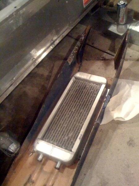

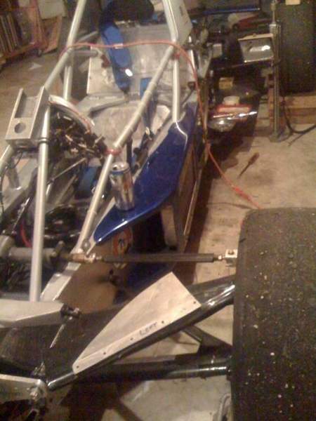

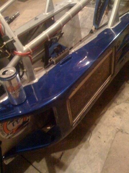

ok racers, here is a subject I have been debating. our formula car uses two aluminum radiators, one on each side. I switched to the Ultra Side pods which are each 5 pounds lighter and 3 inches narrower than the original sets. Benefit is lighter weight and lower aero drag.
now the questions,
1. is it more beneficial to plumb the coolant thru the radiators in series or parallel.
2. Air enters the side pod and exits thru the radiator fins. Is is better to place insulation around the radiator core to smooth the air flow or
leave the radiator bare to help dissipate heat from the sides.
3. the red car photo ( as seen from the front of the car) shows a splitter that spits the incoming flow to the front portion and rear portion of the rad core. I am told that is is not needed on 90 percent of the installations. Note the insulation packed around the rad core.
your keen observations and comments are valued
i will respond as required and as beer permits.
thank you

TSK! Someones left beer cans on your sidepod!
From a cooling standpoint, it depends on how effective the radiators are.
Parallel = potential for more cooling capacity as you are effectively flowing more coolant to the radiators. More complicated as you have to split the plumbing. Series = better cooling on lower flow rates, probably eaaiser to plumb in.
Your best bet is to estiamte the cooling capacity of the radiator, then calculate the maximum fluid flow rate with each scenario. Which ever gives a higher heat transfer value is the one to go for. This will also depend on how good the pump is.
I'd be tempted to say that parallel will probably be better.I don't see the point in the splitter in the red case, unless the flow was seperating on entry and stalling a bit in the sidepod or something like that.
Thanks Chris
the car originally had parallel. we switched it over to series when i went to an electric water pump. temps were about the same...its a 2.0 liter 4 cylinder..
the splitter thing is a last resort i think..no one in our race series runs it. one big benefit is that the series plumbing makes purging trapped air easier.
who left that beer can there!

old side pods vs new ultra side pods
not readily apparent but the new ones are much narrower
again a trade off as the old pods made a much wider diffusser area under the car which increased down force...so we trade off losing a little down force for high speed cornering but gain less drag overall
racing is one big compromise

Ranger Mike,
Looks like a LOT of FUN!
Your first question;
"1. is it more beneficial to plumb the coolant thru the radiators in series or parallel."
Pump considerations;
In series, there will be a greater pressure drop in the coolant piping which will cause your centrifugal water pump to "back up" on its performance curve, delivering lower gpm at higher head. In parallel, the coolant pressure drop seen by the pump will be lower, allowing it to "run out" on its curve to a higher gpm at lower head.
Radiator considerations;
The radiator's thermal performance will be affected by the flow rate... of both the coolant and the air. When deciding between series and parallel plumbing, remember that coolant (tube-side) flow should be kept as near to the design flow rate as possible. Lower flow will reduce coolant turbulance which will reduce heat transfer efficiency. Higher flow can cause cavitation which will erode the tubes from the inside out. The air flow (fin-side) should be as uniform as possible across the face of the radiator. To achieve this, some sort of splitter might be beneficial.
Heat transfer considerations;
Generally, you want to operate with as high a delta T between the coolant and the air as possible. This is because heat flow goes as the log of the mean temperature difference (LMTD) between the hot (coolant) and cold (air) fluids. Taken alone (without consideration of other factors discussed above) this means that parallel piping will give the greatest cooling efficiency because both radiators will see the maximum inlet coolant temp. In series, the inlet coolant temp to the second radiator will be lower due to pre-cooling through the first radiator.
Your second question;
"2. Air enters the side pod and exits thru the radiator fins. Is is better to place insulation around the radiator core to smooth the air flow or leave the radiator bare to help dissipate heat from the sides."
The "insulation" is most probably there to eliminate by-pass of air around the radiator. The heat exchange (coolant to air) will be most efficient at the extended surface of the fins. Heat exchange at the headers or through the frame of the radiator will be relatively inefficient. Keep the air flow across the fins.
For your third question, see "Radiator considerations" above.
Have fun, and remember; "Keep the shiny side up!"
