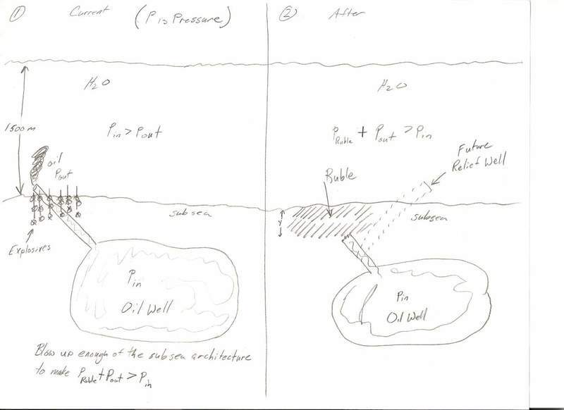

What about series of detonations? This could be a quick fix until the relief well is drilled. Detonations can be performed in a matter of weeks. I hope they are not trying alternative methods for the sake of reusing the well bore or to continue to collect oil. They need to stop the oil ASAP.
Drill many small diameter holes lined with explosive ~1000 meters around the well bore. Use the series of detonations to implode the well hole and cover it with ruble (i.e. make the Pressure inside the well<Pressure outside the well). I almost feel that the extreme pressures of the environment would allow for more controlled explosions or implosion from the detonations. This could stop or slow the leak until the relief well is completed.
I did some rough calcs and oil pressure at ~5000 psi, one would have to implode and cover it with ~1000 meters of ruble. I wonder how many meters they can drill in a day?
I have not heard of ideas regarding detonations of the subsea architecture or an implosion of the well head. What are the risks besides letting the oil leak like it has been for the last month? I am sure the have the well bore mapped.
BP should release some stats on the problem (i.e. map/diagram of the well, P's, T's, and V's, effluent components, flow rates, surrounding material properties, etc.) so some independent engineers can be more serviceable
