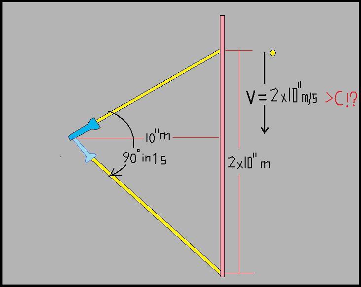

Suppose you have a source that send a very strong straight beam of light (say laser )
Then you direct the light toward a distant wall with angle 45 degree
as show in the drawing below
Then if you rotate the source 90 degree in one second, what is the velocity of the visual effect (spot)on the wall?
According to the distances given in the drawing it must be greater than the spead of light !!!
I do not know if any one think of this before but I hope I will receive more comments and analysis about this simple case.

How does someone standing at the top of the screen use that spot to send a signal to someone standing at the bottom of the screen?
Mueiz
#3
Jan12-11, 02:10 PM
P: 188
Quote Quote by jtbell View Post
He can use another spot signal to the person who hold the torch.
and the total velocity of the signal from the top to the bottom will be still greater than C

How to send a faster-than-light signal (spot Paradox)?!
Why not just shine the light at both places at once?
The spots that the light shows hold no information about that point. It's just light sent from the laser to that specific point. If you want some information from that point it has to send a signal back.
Sure that point might look solid to you but it's just light being sent from the light source. Or think of you light source as a machine gun and the light as a bullet. Sure it might look like you drew a line on the wall but it's just a bunch of bullets.

Please reread what I said.
The light can carry information from the light source to the spot. But the spot can't carry information from one spot to the other spot unless it sends information back to the light source.
The only information is coming from the light source so you aren't sending any information from first spot and the last spot.

I read what you said well..but you did not read my second post
I said that if the person in the top of the screen want to send a signal to the person on the bottom He can send first a spot signal to the source the source will send a similar signal to the bottom ..the final result is a signal from the top to the bottom which is faster than light also.

Doc Al
#18
Jan12-11, 05:50 PM
Mentor
Doc Al's Avatar
P: 41,436
Quote Quote by Mueiz View Post
Nah, that won't work.
If person (A) at the top of the screen wants to use that torch to signal to a person (B) at the bottom, he must:
(1) Send a light signal to the torch holder (at T)
(2) Have the torch holder shine the light towards the second person (at B)
So the signal must travel a distance of A to T, then T to B. He'd be much better off shining his own light directly at B! (If the torch holder wastes time sweeping the light from A to B, it will take even longer for A to signal B.)
If the torch is simply swept from A to B, the apparent speed of the spot may well be greater than c but it is useless for signalling from A to B.
