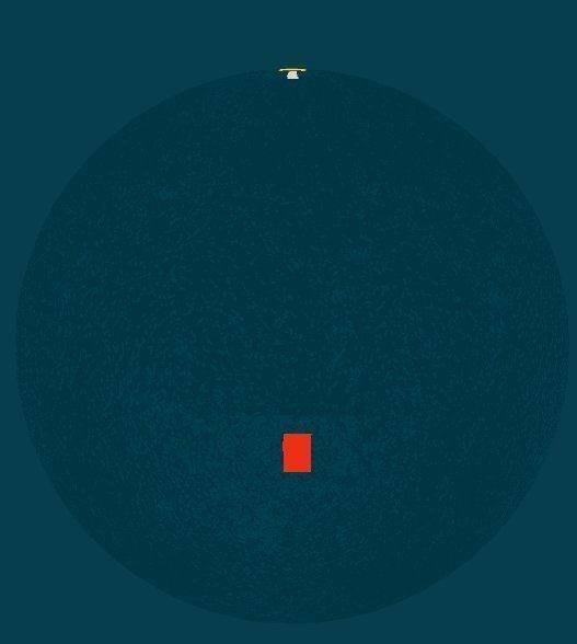

i'll did some illustration to show you a little bit more clearly what is my problem:
there are attached images:
4. 3dWithNorthPoleOnCenter.jpg (you can see it on the next post - since this forum allowed max 3 images in thread)
the #1st image is the distorted texture for wrapping the sphere.
the #2nd image is the sphere (after #1's wrapping) without any rotation of the sphere.
the #3rd image is (about - ~) 45 degrees rotation (north to south / up to down)
the #4th image is (about - ~) 90 degrees rotation (north to south / up to down).
as you can see there are 2 objects on the #1st image (red and yellow), in the real world they're with the same surface/dimensions and this is the reason you can see them dimensions equally on the sphere while you rotate it, but in the #1st image i must have the distortion (as we already discussed before) so the wrapping of the 3d sphere will show the right data.
i did the #1st image by my self with Gimp (this is the reason it's not 100% equal - I'm a programmer - not a designer !:)) and what I'm looking for the some math formula that allowed me to generate this image (#1st) automatically based on the data i have on the DB (as you probably understood - the data from the DB is the 2 areas on thew #1st image: red and yellow)
this formula should grow/decrease the object dimensions follow by your location: as much as you go to north or south your height will grow and east to west your width will grow.
hope it's better explanation.
TA
Shlomi.

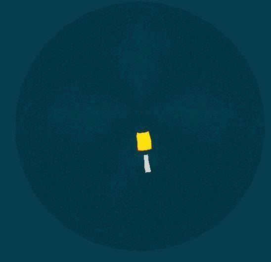

as i understanding, the distortion is needed.
to show you that - i took the same 2d image like before (2d.png) and i added a non-distorted object on it (the gray one) but i left the distorted one (yellow), now, you can see those objects on the sphere (sphere1.jpg, sphere2.jpg and sphere3.jpg), the distorted (yellow) look realistic but the gray one (that have the same dimensions like the red but another location on the world) not appear realistic, if I'll convert it with the same distortion like the yellow one it'll looks fine.
Over the weekend i read a children book (of my little daughters) that explain things about geography and i found an explanation about how create maps based on sphere (see cBookMerkator.jpg) and i found the 'Mercator projection' method, i think this is what i need but i need to find the proper math formula that let me create the distortion function.
i found http://www.experts-exchange.com/Programming/Algorithms/Q_24509438.html" article on the internet but the answers are costing money :) so i'll keep search.
[P.S. sphere1.jpg and cBookMerkator.jpg are attached on the next post]
