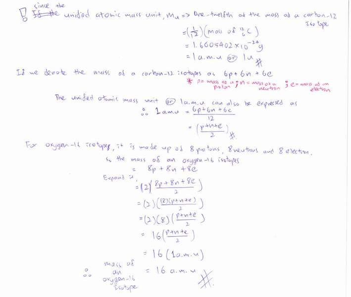

may i ask what does it means by the mass deficit ? and you mentioned that oxygen-16 isotope has a mass different from exactly 16 a.m.u. but i think oxygen-16 isotope should have a mass of exactly equal to 16.a.m.u. Could you please refer to the attachment i posted and help me to mark my calculation? thanks sir!

a new question, is it true that the mass of an atom(atomic mass) is equal to the total mass of of all the protons, neutrons and electrons in that atom ?? and is that the mass of a atom is always constant ??

im sorry about that because frankly I am a A-level student. I have been studying the piece of information that you gave me . Up to this stage i can almost understand the mass defect. But i am still not satisfied with the statement"No other nuclides other than the carbon-12 isotopes have exactly a whole number relative isotopic mass in the scale taking 1/12 of the mass of a carbon-12 isotopes as a standard. ". Because i found that since the relative isotopic mass of nuclides of different isotopes is just a ratio compared to 1u, then there will be other nuclides having a whole number OR non-whole number relative isotopic mass.For example the mass of an oxygen-16 isotope is exactly 16 times greater than 1u. I have showed some evidence by myself. Could you please help me to verify my attachment? Moreover i think that the rest mass of protons,neutron and electron are always constant while static but while moving as in real word the mass decreases. My question is what is the extent the mass will drop to and will it be fluctuating with time ? i really need your help
According to the links below, the mass of O-16 is 15.9949 u. Close to 16 u, but not exactly.

It is not simply a matter of adding the masses of the protons, neutrons, and electrons. There is an energy change when these particles are combined vs. when they are isolated. The energy change will contribute to the mass of the atom, via the famous relation E=mc2.
If not for this mass-energy equivalence, there would be no energy given off in nuclear reactions.
Thanks so much for your explanation. But could i say that my above attachment is only correct when both the carbon-12 isotope and oxygen-16 isotope are under the same condition, for example both are in isolated form, same temperature and all other possible factors that affects the mass? And one more question, since you said that mass of the atoms are different when in different forms, because of this the unified atomic mass units is apparently a constant but precisely it is a value that keeps on fluctuating at but only at the position of the uncertainties. the same things for the relative isotopic mass of every isotope. They are always fluctuating but only with an extremely minute deficit, is it true??
