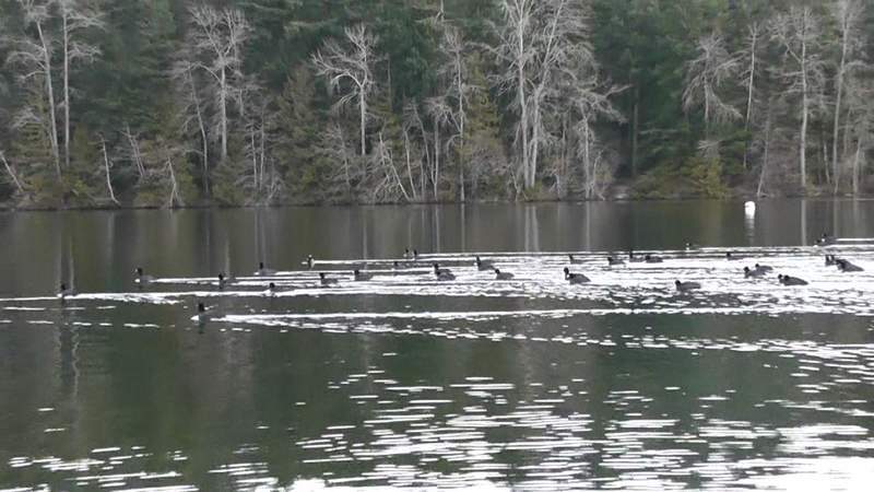

Hi Chiro. Thanks so much for responding! I've attached a photograph to show what I'm looking for. Hopefully you will be able to access the photo. On it I show a standard measure of a bird (American coot) at 37cm, and the red angle line(s) to the bird I want to find the distance to. The angle shown was just my attempt to try a small angles measure to get the distance, so ignore the angle, but the red lines show the distance I'm hoping to measure.
Basically I want determine the area in sq meters so I can figure out the density of this group of birds. I have a good measure of the length, I just need the second dimension to be able to determine the area. Thanks again for your help!

dodo
#4
Feb24-12, 12:22 AM
P: 688
Measuring distance between objects of known size in photo
Hello, Hugh,
I was going in the same direction as chiro's. Your question falls in the subject called 'photogrammetry' (literally, taking measures on photos). You may do some calculations if you know your camera's CCD sensor size, for which you may consult your camera's specifications and compare with this link:
http://www.dpreview.com/news/2002/10/7/sensorsizes
And you will need the focal distance of the lens you used to take the photo. If it is a fixed lens, that's easy: you'd know if it is a 55 mm lens, or whatever. But if it is a zoom lens, you're going to be in trouble, as you won't remember how did you manually move the zoom position. Unless the photo has digital information recorded on it (EXIF data records added to a JPEG photo, for example), where the actual focal distance has been recorded when the photo was taken.
If you happen to have all this data, then you can imagine each pixel on the photo to be a 'ray' (a line that comes out of the focal point of the lens, passes 'through' the photo, and hits the bird in the world outside). The actual bird position is anywhere along that line; but you can estimate it as you know the real bird's size. The calculations hinted by chiro then would take place.
The objective of these calculations is to obtain three-dimensional coordinates of the bird's position in the 'world' outside the camera; then it is a simple matter to calculate the distance between two of these points in the 'world'.

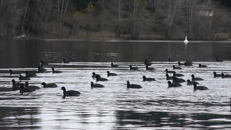

Hi Dodo. Yes, actually you are right, I know now that I did use a zoom button to zoom in a fair bit for the photo.
I went back to the video and have re-captured two photos that I can use for my analysis. One is not exactly the same still as the one before, but close. For that one I was using very little zoom, perhaps 2 - 3X, while the close-up was from about the same distance away, but using quite a bit more zoom, possibly the maximum.
Either one or both (preferably both) would do for me to find distance between nearest and farthest birds, so as to ultimately approximate density. Let me know what other info my help.

Ah, thanks, Hugh.
One problem is that I can't find information inside the photo, like the one you mentioned before,
Quote Quote by HughT View Post
Dimensions w 639 H 347; Horizontal Resolution 96DPI; Vertical 96DPI; Bit depth 24; 35mm Focal Length.
How did you find this data for the other photo, and what would be the data for these two? I can see the size, which is fine this time (1280 x 720, so proportions 16:9), but the "focal length" for each photo is critical.

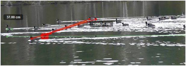

Thanks Stephen and Dodo. I would be happy with a reasonable approximation, as long as the method is supportable (would want to refer to it in a potentially publishable paper). Does it help if I find two birds that align at 90 degrees, as shown in my new attachment? Again, we can assume both birds are 37cm long. Also, when video'ing, I was on my knees, and I've just measured my eye-level at 122 cm (an approximation to be sure given that I may have been crouching slightly).

I think a simple idea would be to use two coots which are horizontally at the same level in the photo, and that have the same size (so they are at the same distance from you). Then you can use your proportionality method (and be able you justify it yourself in your paper) to estimate the distance between the two birds. But estimating distances in the back-to-forth axis, that will not be that simple.
Another recommendation I would do is to make the measurements on the photo in 'pixels' (any paint program should be able to tell you pixel coordinates as you move or click the mouse). All units on the photo must be the same (f.i. pixels), and then all units in the real world must be the same (for example, centimeters); but there is no need for the units in both photo and world to be the same. And measuring in pixels on the photo will give you far more accuracy than trying to use a ruler on such small distances in the photo.

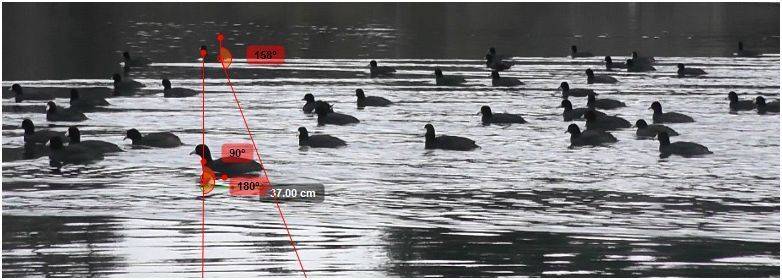

Thanks for everyone's help on this. Unfortunately I didn't take any still photos of the scene, and, being on the water on an stand-up paddle board, it's not possible to for me go back to physical location and retrace distances to any landmarks in the photo. I do know better what what information to get for the next similar shoot, thanks to everyone here.
As it seems the problem is rather intractable for the images I have, I've decided to use a perspective grid (see attachment) that somewhat applies my "scale-averaging" notion earlier. It still involves a fair amount of eye-balling but it gives me a standard I can apply to other video-stills, whereby I match a grid unit to the size of a near bird and then adjust the grid so that a grid unit in the distance will roughly scale-map over a bird of similar orientation in the distance. It's rough it to be sure, but it gives me some way to indicate density. If it doesn't work for the editors/peer-reviewers, I can always just omit and say that I haven't been able to accurately measure density. θ-)
