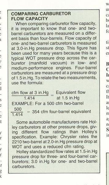

one racer wanted to know how to compare 2 barrel to 4 barrel
here is table from Holley Carb and manifold book
Should point out Mike that if there is a carb used that utilizes exchangable boosters there can be some differences seen just in this aspect for the better if changed.
