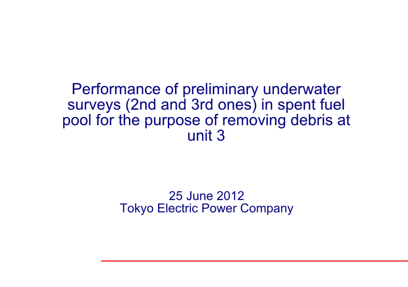

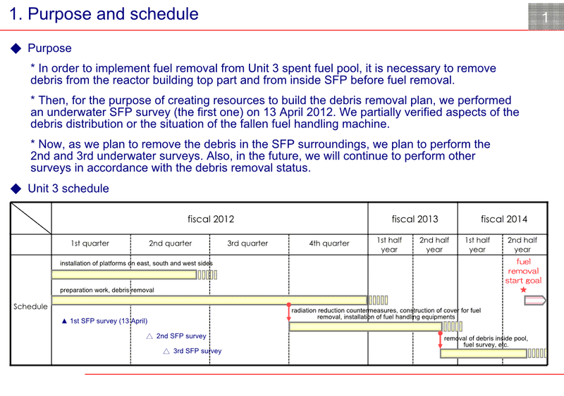

Quote by tsutsuji View Post
The 7th mid long term meeting was held on 25 June:
3-5 Countermeasures for spent fuels pools
http://www.meti.go.jp/earthquake/nuc...20625_02bb.pdf Performance of preliminary underwater surveys (2nd and 3rd ones) in spent fuel pool for the purpose of removing debris at unit 3.
Translation:
1/4
2/4
